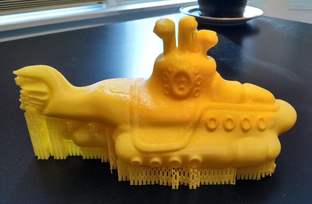

I prefer to set the extrusion width manually because in the old version at least, auto would incomprehensibly choose wider and wider values as the layer height went down until it was something ludicrous at 0.10mm. 2.1 does not appear to do that. Extrusion width is a matter of individual taste, anyway, with trade offs, as long as you are not set too low or too high. Anywhere between 0.40 and 0.50 for a 0.35 mm nozzle should be fine, with lower values allowing for finer resolution in the XY plane, but larger values shortening print times and being better for adhesion.

I don't know if it was the corrected Extrusion Width setting or just dumb luck, but I was finally successful with the print! Originally I was having problems with the front of the bow lifting above the support, but the last print had that perfectly level. The only problem this print did have was a little model lifting above the support on the back corners (below the last porthole), but it was minor enough that the person I printed this for won't notice.
Overall I'm quite happy with how it came out.

Looks pretty good to me. After all the discussion I was wondering how it finally turned out- it's nice to see a successful outcome :) (Even if it was random luck. But there's method to this madness and my bet is on the extrusion width, though for which one of the proposed reasons I'm sure I couldn't say!)
