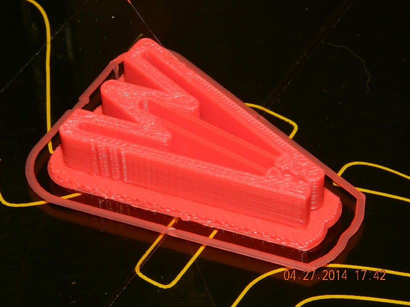

Re: Using ABS
Reset M2 settings by deleting all old S3D configs, have first layer temp now at 250.
This might work, but after messing with the printer and software all day, next try will be tomorrow.
Loose set screw on filament drive gear really set me back. Looks like progress.
Smallest allen hex wrench in the tool kit allowed me to fix this issue.
Extrude/purge works every time.
Wished I have bought a kit now to provide better understanding of the M2.
