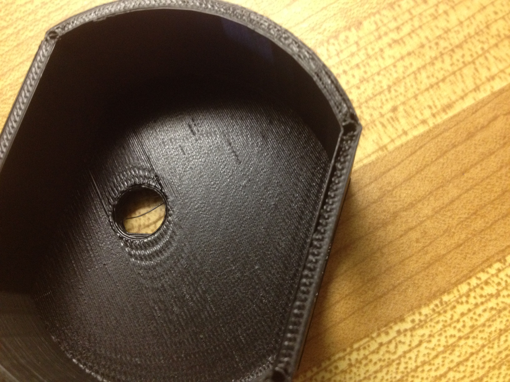

I'm still new to working with ABS and am encountering some issues. My prints often have gaps between the perimeter and infill lines. Also, when I have small holes in my file, the print ends up going over and covering part of the hole. When I view the print preview, none of these issues appear. I'm using jimc's ABS profile - https://groups.google.com/forum/#!msg/m ... EId-LqyBsJ. Anyone have any idea how to fix this? I also included the factory file for one of my issue prints.

colin wrote:gaps between the perimeter and infill lines
In this situation, geometry is not on your side: there's no way to fit a 0.4 mm thread (or whatever width the slicer is using) into the acute angle where those holes don't quite meet the perimeter. The slicer must end the infill thread where it touches the threads on either side, because it can't make the thread any narrower.

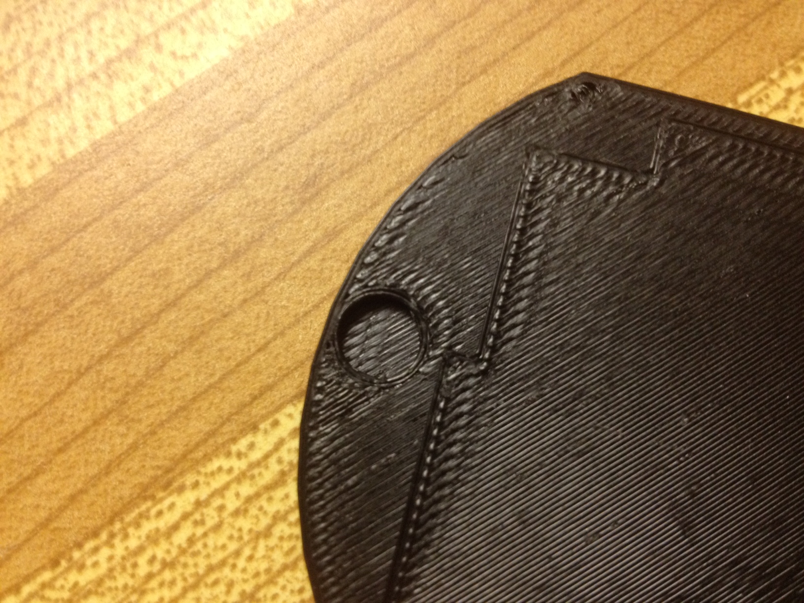

A similar situation occurs in the thinwall section of the second picture, where the infill threads become tangent to the perimeter wall. Because the slicer can't make the threads wider, it can't fill the slivers between the infill threads and the perimeter threads; if it moved the thread over to touch the wall, the thread would become thinner (and shorter), with a similar sliver near the other wall.
It looks as though the extruder isn't squirting out quite enough plastic: the tops of the walls look a bit sunken and the top infill of the lower plate is slightly ragged. Bump the extrusion multiplier up a bit and see how that affects the results. It still can't fill the tips of acute angles and parallel slivers, but they may become less noticeable.

Post by jimc » Sun Jul 06, 2014 4:33 am
ed is right. your underextruding. check you filament dia with a pair of calipers then make sure thats set right in the profile. also, as ed said you can bump up the multiplier a bit.
