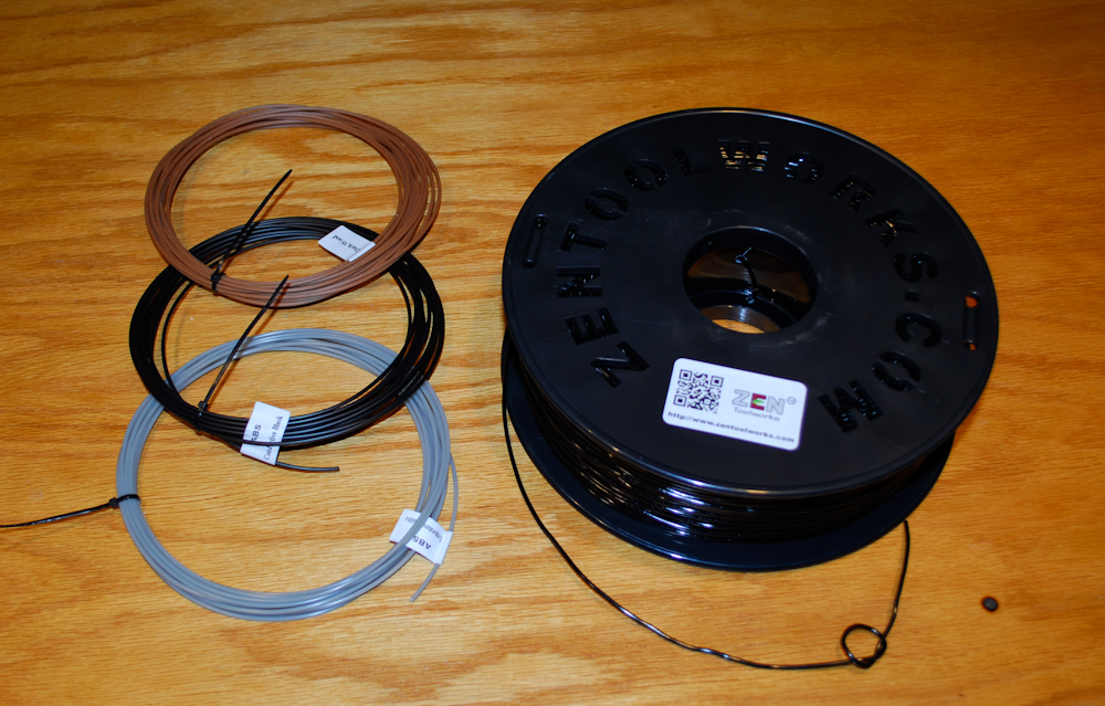

My Zen Toolworks Flexible Filament showed up too day from the Kickstarter campaign it came with a few extra samples too. A Dark Wood Filament, a Conductive Black ABS, and a Temperature Sensitive ABS. (not sure what I'll do with these besides the wood but might be fun to play with.)

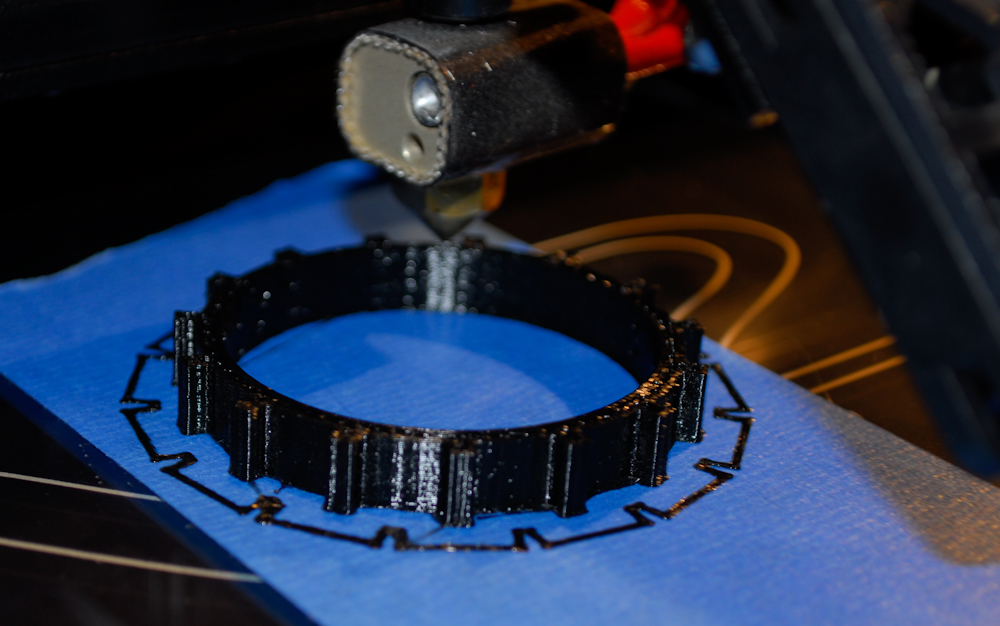

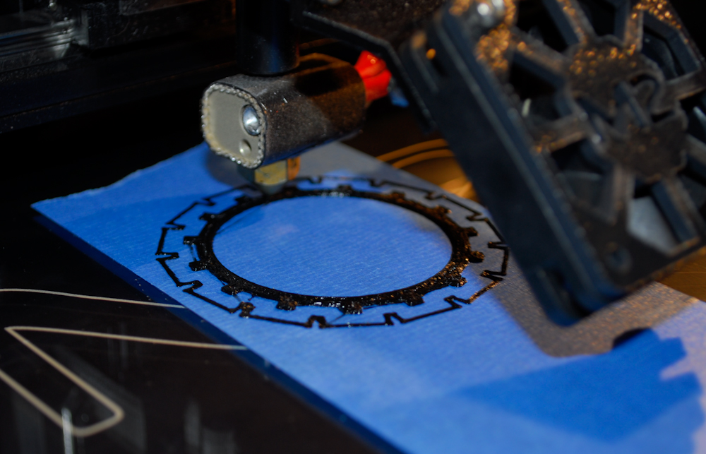

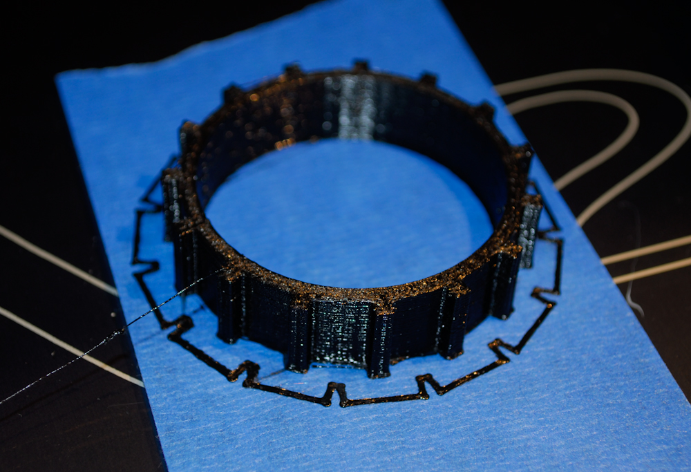

I don't know much about this stuff, I actually bought this off KS before I even had a printer. Anxious to try this flex stuff out I drew up a quick wheel/tank thread thingamabob to see how this worked. Besides the note to run this stuff at about 240 I just used the PLA medium setting in S3D and after a quick search of what works with Ninjaflex I ran the bed at 40 degrees and printed on blue painters tape. As flexible as this was off the reel I fully expected this stuff to give me feed issues or just clog my nozzle but figured what the hell let see what happens. If fed right into the extruder without any problems and the first layer went down just fine.
15 minutes in and its not looking too bad.

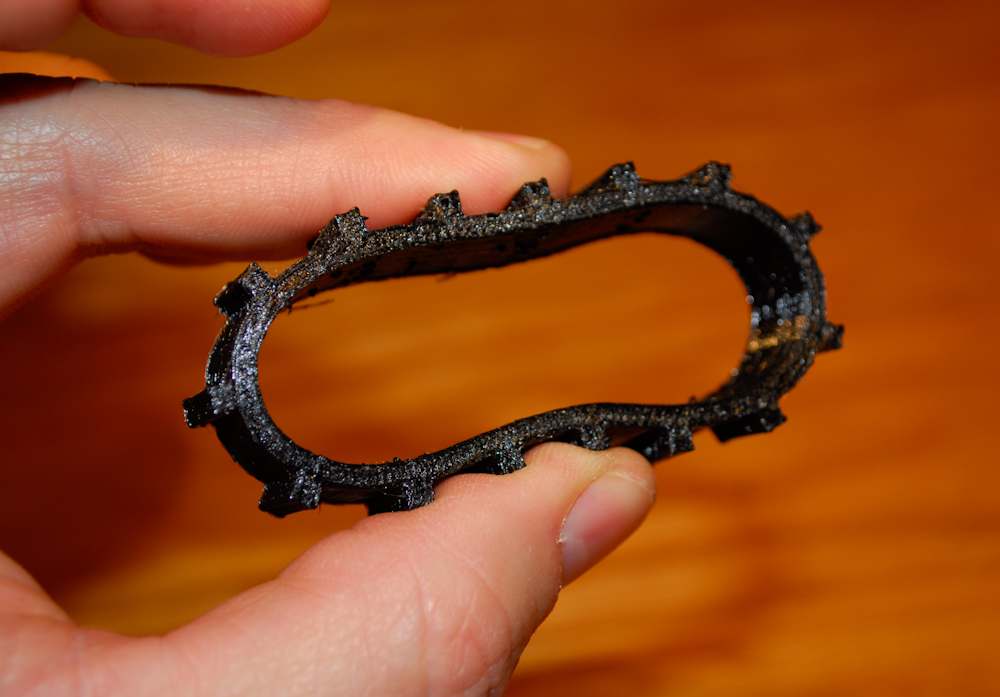

The finished print came out better than I would have ever expected for a first try. (I still can't believe how awesome and easy the M2 is to use.)
I wasn't sure what to expect only printing with PLA and ABS but the finished product is pretty flexible, I think with a few tweaks and some practice it will work for tank tracks and other bendable like things like belts too. This definitely opens up some cool possibilities. Thanks Toby for originally posting this.

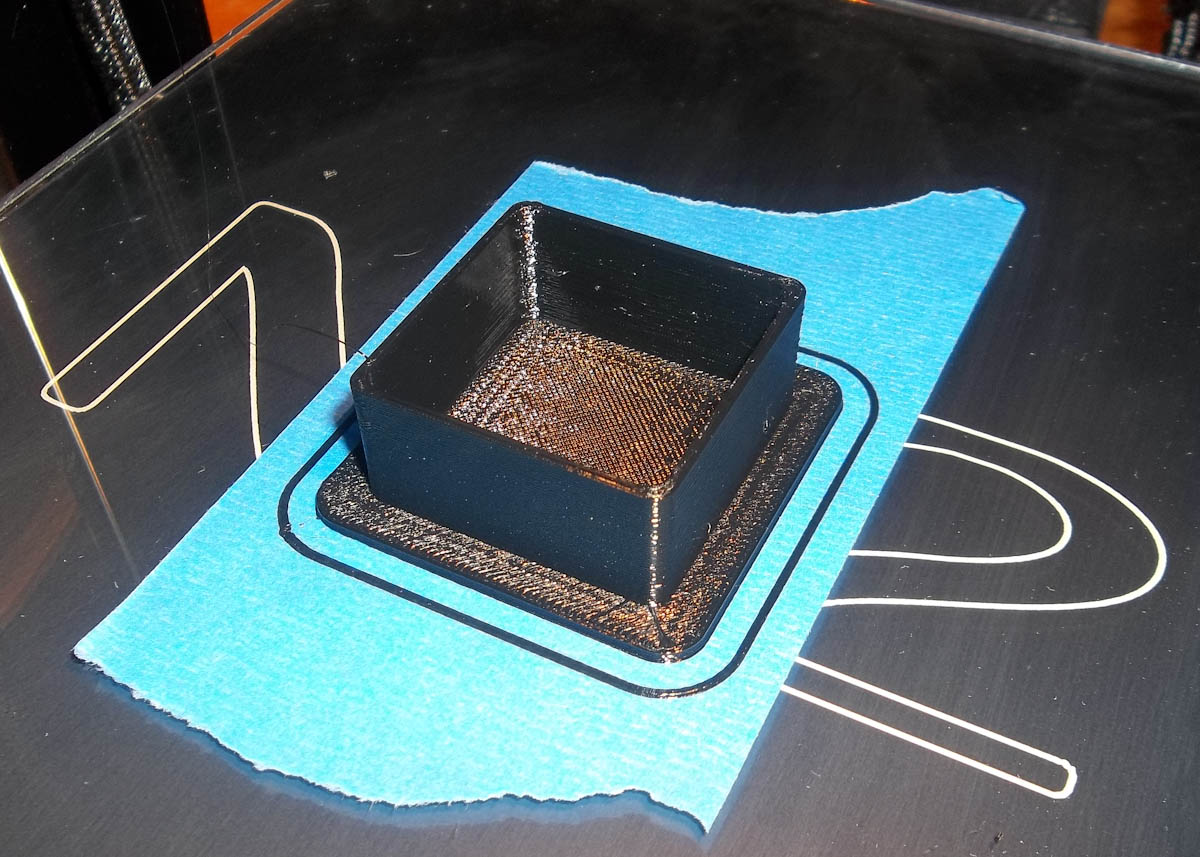

Post by sthone » Wed Nov 19, 2014 2:00 am
Just another quick update if anyone is interested. These are simple caps for the ladder rack mounts on my truck I wanted to try something with a flat surface this time. I still didn't see any indications of the corners trying to peel up but I did have some feed troubles this time. Initially the filament kept wanting to wrap around the extruder drive gear so I ended up having to remove it from the motor at least 3 times before I finally got frustrated and just feed it through both holes in the extruder and then stuck it back onto the motor. After that it worked perfect again.
