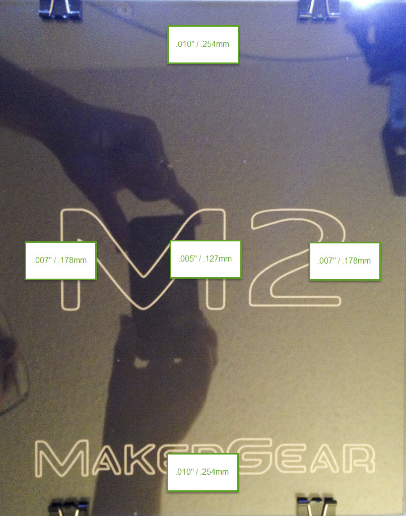

I'm seeing similar with my glass. Heat at 70C, at the center of the glass I have it gapped at .005" but near the left and right edge from there the gap is at .007" at the edges. Is that, as they say, close enough for government work? Not sure what else I could do since both edges are at .007" so no sense in tilting the bed. Would a .002" difference between center and edges be acceptable to most of you?
EDIT: Took a couple of more measurements, on the "Y" axis the difference is much bigger as shown in the picture. Again, not sure if that variance is considered acceptable? Measurements are approximate based on feeler gage just barely touching extruder tip. I ordered a spare glass with the printer and switched to the spare after the first day since I noticed the center was higher, but the spare is the same way. I'm assuming its normal but that .010" seems kind of a big difference from .005". Maybe not though, I don't have enough experience with these printers to know what is acceptable.
Thanks
Thanks

Glass in general is not perfectly flat. .005" is pretty small and not uncommon. I have one piece of glass the same as you have pictured and one that is pretty close to being flat. I think its just by chance you happen to get one thats perfect. A .005" variance as a beginner can be annoying but you can work around it with s3d by printing a thicker first layer.
