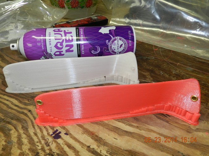

Thanks to jsc added more supports and printed the models vertical instead of horizontal.
Result was 2 finished sides that looked much-much better.
Here's the supports thru S3D:
Models 003.jpg (105.57 KiB) Viewed 7450 times
On the backside of the fish flasher models there's long pillars that hold the model
just fine as it prints. Piece of cake with S3D.
After trying Kapton and blue painters tape, Aquanet hair spray shown in the
photo solved ALL sticking to the bed issues.
