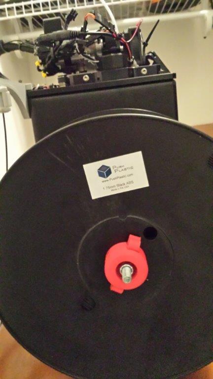

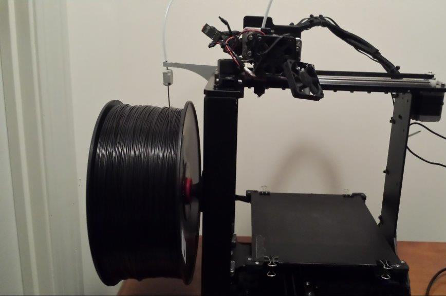

I just got a new 3kg 1.75 ABS but I did not have a big enough spool holder for it.
I found this one http://www.thingiverse.com/thing:119488
It is a really good design. It fits M2 without any screws. It makes this 3kg spool spin very free.
I will not have to change spools so often now.
On the first picture you can see I used two clips to keep the spool on. I am not sure that is needed but better safe than sorry.

haha spool is massive. it looks like it will tip the m2 over on the left.

Nifty setup with the filament wiper, great job.

No fear of it tipping over M2 is much heavier. It does look big on there. This will be so much nicer not having to worry about running out so fast now.jimc wrote:haha spool is massive. it looks like it will tip the m2 over on the left.
We print alot ABS and this 3kg spool is really going to help.
