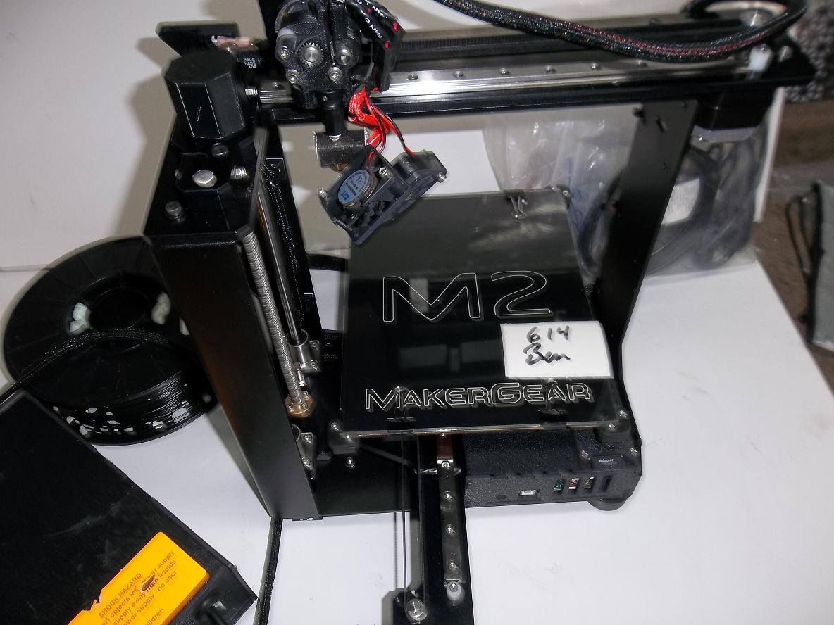

This is what I'm thinking of getting today. Is there any way to tell if this is a gen1 or 2 version?

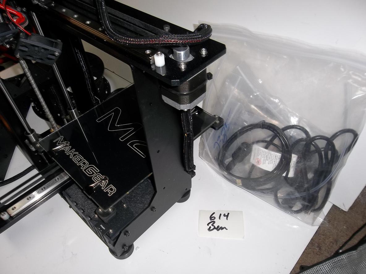

here is another picture. It looks like there are two power cords, which would make me think this is the older version.
Can I upgrade this to the newer M2 version?

looks like it has a v3b hotend which would make it fairly new.
Dale Reed
Posts: 376
Re: Getting a used, broken unit
Post by Dale Reed » Sat May 10, 2014 7:33 pm
Yeah, one of the cords I see there is the USB cable. Definitely the V3B hot end. Does it come with ONE power supply (with a MakerGear over-enclosure) or two bricks (one probably says "Dell")? Looks like the single 24-volt supply is there at the bottom left corner of the top photo, so this would be the newer 24-volt design. It looks fairly clean and new to me. I don't see any dirt (good) or grease (maybe not good) on the X and Y rails -- so, yes, make sure it moves smoothly. Spin the Z knob, or lift the platform by hand. Gravity should make it go back down, spinning the lead screw. The electronics enclosure looks like the newer design --- not the laser cut glossy acrylic that I have on my 4/2013 unit. I'd jump all over this one!

From the first photo is looks like the power supply is the one box 24V unit, so this printer would be no older than last Fall I'd think. My biggest fear would be that it had been dropped and maybe bent on the Y axis. From the photos it's hard to see what's abused about it - does it look dented?
