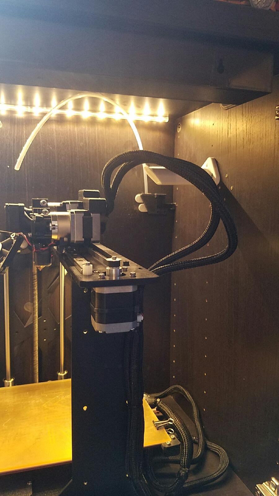

Here's the setup of the tube inside the cabinet... Having the printer "sideways" actually makes it easier to access all three leveling screws. Also, the printer frame is not in the exact middle, so it's still easy to remove prints. The print surface is a sheet of ultem bonded to the glass with 3m adhesive. No more slurry, glue, hairspray or whatever you guys use. If I want to print Ninja, I simply turn over the glass and print on bare glass (Dont print Ninja on Ultem/PEI surface).

Thanks, for the reply.
I actually settled putting the roll on the back of the case and the filament tube is only attached to the extruder. It seems to work fairly well, no jamming so far.
I just wish I had discovered this thread before I wasted money on making a plexiglass enclosure. So much nicer and professional looking.
