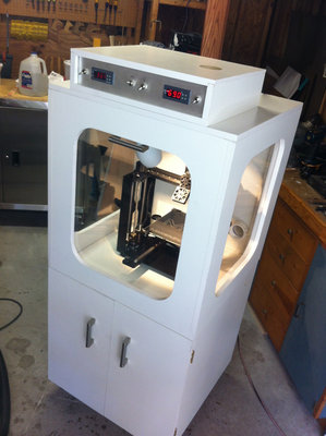

This is the one I built from scratch. The bottom cabinet is for filament storage and the printer section is temperature controlled. One thing I really like about this design is the slide-down door, since you can open and close it without a big door swinging open. It's only possible to do that when you have a lower section for the plexiglass to slide down into. I'm going to be making some more compact stackable boxes but won't be able to put a sliding door on those unfortunately since there will not be a cabinet under the printer. The only thing under the printer will be another printer :)

Post by Jules » Fri Jan 08, 2016 11:55 pm
Wow, that is a beauty pyro......
