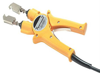

I'm still interested in getting an easy filament splicer to do that sort of thing manually. That kickstarter splicer seems like it was a minor flop, people complain of it tripping house breakers. I did read up on it, though, and learned about PTC resistors, which maintain a certain temperature when fed a given voltage without the need for active control. They're not very expensive, either. The hard part is coming up with a way of getting a heat conductive sleeve in two halves, so it can come apart (hard for someone with hardly any appropriate tools). I thought of splitting a brass tube, but 1.75mm is not a standard tube size. I guess I could get one printed at Shapeways.
Ideally I want something like this:
Maybe with PTC resistors on both sides, powered off a hefty LiPo 12V.
Anyone have any machine tools? :-)

mcmaster 2900A227 + 88605K22 + square steel bar + flat steel plate
Put the shim inside the brass tube, roll back and forth with the steel bar against the steel plate until the tube compresses down

jsc wrote:I'm still interested in getting an easy filament splicer to do that sort of thing manually
Just print a jig and use it as a guide to superglue it. According to the internet, the melting point of set superglue is 187°C, lower than any print temperature. If you are lucky, it will flow right through the nozzle. If not, then it will be the perfect nozzle obstruction. I would try it now except I am not at home and don't know where my extra nozzles are.
