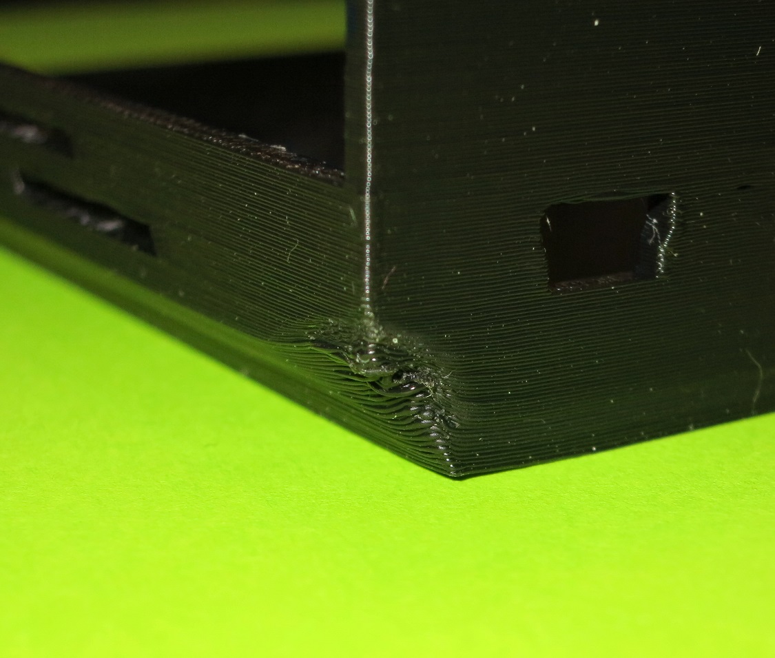

Help! New to 3D printing and still trying to learn. I have this problem on an enclosure that I am working on. Two corners were ok, two corners have problem shown in the attached image. I can't figure out why. I tried Wipe as well as Coast for 0.5mm, didn't make a difference.

Difficult to see from the picture---are the corners lifting up? Is there an overhang on the side? What type of filament are you printing in?
Lifting at corners is pretty common for large, flat objects with walls, like enclosures. Enclosure bases are like worst-case scenarios for shrinkage. PLA ought to be okay, but ABS and PET will shrink until something is forced to give way. You can add a wide skirt, or at least "mouse ears" at the corners to help keep the corners down, but shrinkage creates a LOT of force. . . there are a number of people who have found that a large enough ABS print with a strong enough adhesion to the glass will simply break the glass. I'm sure there must be design techniques for alleviating the stress from shrinkage, but I'm not a mechanical/civil engineer. I tried a few things on my Smoothieboard enclosure design, but I don't think they were particularly effective.

It is hard to see but is the edge on the left at an angle for the first 20 or so layers, like a chamfer?
If it is I would say this looks like curl. Where the edge is being printed further out from the one below and it curls up. Then when the next layer is put down further out it will either push down the curl but it deforms that layer and the curl bounces back up or it goes around the outside of the lifted edge and droops and sags with no support.
First thing to try would be to make sure you are printing the perimeter inside to out. This can affect surface quality a small amount but when you print over hangs it can make all the difference.
Plastic shrinkage plays a big part and if this is ABS try switching to PET(G or +)
Slowing down the print speed should help. You could try slowing just the perimeter speed more. I have not tried that yet.
I think over extrusion plays apart so you might dial back your extrusion multiplier a small amount.

It doesn't look like pull up. My guess is you are printing in PLA and the two bad corners are the ones in the rear. The other two corners are okay because the bed fan is blowing directly on them. Try putting a desk fan at the back of the printer blowing forward. You can also try printing a shroud for your extruder that will direct more airflow to the print area. This only applies to PLA.

For a .2 layer height those layer lines look fat to me. I wonder if z height and bad bed level caused this....are the two corners opposite diagonally from each other that are doing this ?

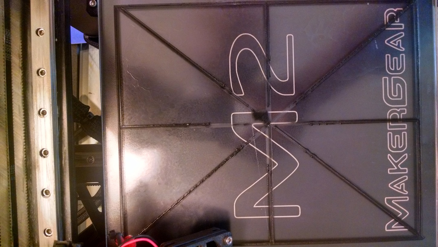

Yes, I have been having problem with the HPB being about 0.2mm higher near dead-center. When I clip the glass bed to the HPB then the glass seemed to curve down from the middle out. This makes bed leveling and printing the enclosure much harder. I had to print it at one of the corners and try to avoid the center area. And to compensate for the difference, I had to increase the extrusion rate to find a balance between one side having too much and the other side having too little. Picture attached.

Side note:

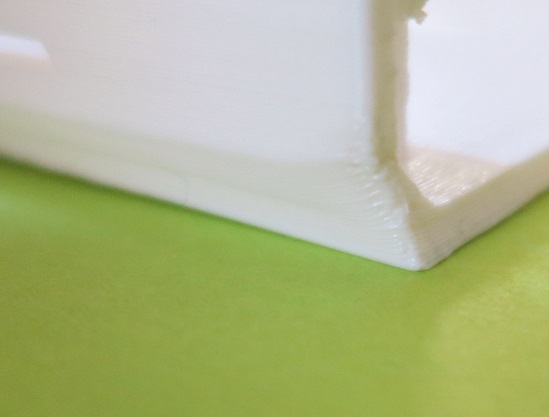

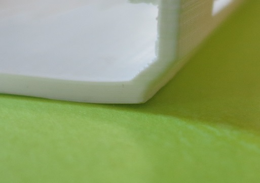

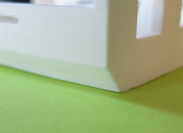

Tried the glue but I just can't get a nice even layer and that flat first layer just didn't look good at all. So I ended up with hairspray that gives me a nice smooth first layer.
So I re-orient the enclosure 45 degree (which I think changes the corner that get the least airflow to the one on the front now), add 1 layer of brim, and slowed down outline speed by to 50mm/s (was printing outline at 85mm/s). My printing time almost doubled but the result looks much better thought still have the same problems, just not as bad.
Now I need to figure out a good way to add a small fan and play with extrusion rate.
