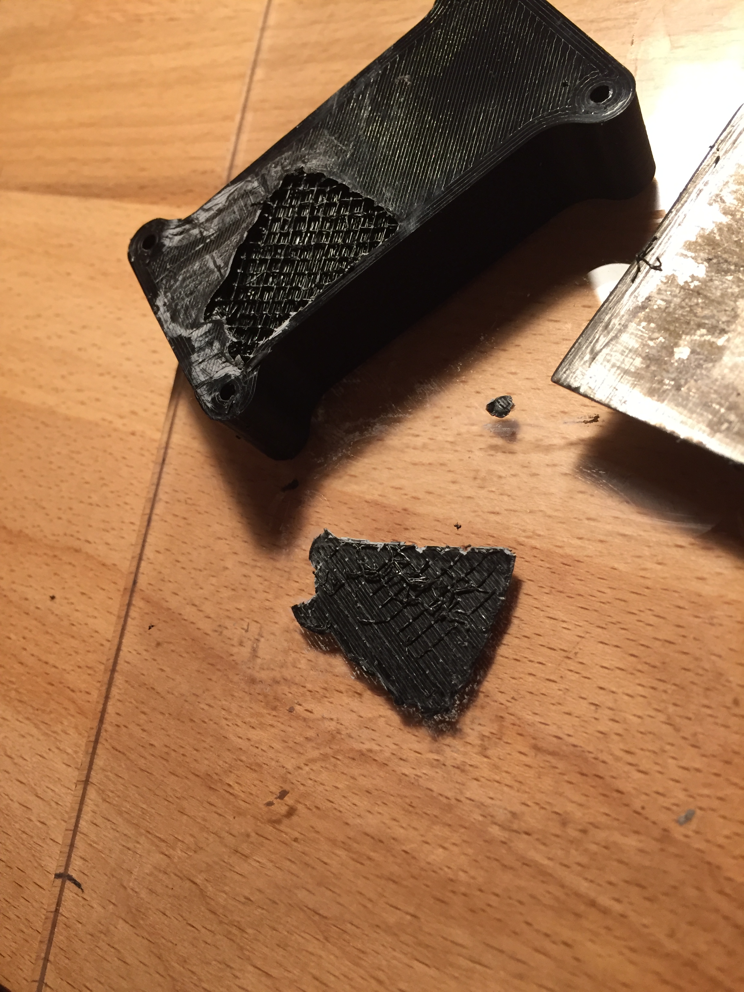

Gaaaah, ABS Juice on Glass keeps doing this to me' probably 1 out of 3 prints. Sometimes when it breaks free it actually tears a chuck out of my glass, which makes me even more aggrivated!.
Aside from ABS juice (acetone and filament) directly on glass; is there another setup you guys have had good luck with when printing ABS parts that have broad contact surfaces on glass? The bed temp is 110, nozzle 150 and I'm using Makergear Black filament.

Whoops - yes its 250, misprint on my part. IL give the PEI a go, I used to work with PETG but had alot of trouble on larger parts, ABS prints beautifully, if I can just get it to not break my damn glass all the time. I saw a video the other day where someone had a flexible panel what they would remove once the print was done and simple twist (like an ice tray). Wish I could remember the name.

Yep - In fact tonight I had two parts which separated themselves and took huge chunks of glass along with them. They ruined the plate completely. It set probably 2 hours and was easily room temperature by the time it fractured free.
