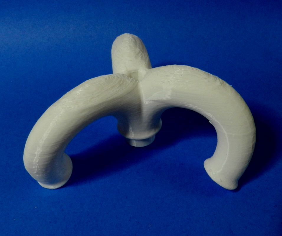

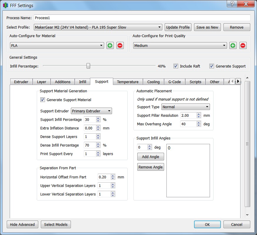

Looking to the group gurus for advice on getting a smoother finish on the bottom of curved parts. The part below shows what I'm getting currently with a layer height of .2mm. I've also attached a pic of the support settings I'm using in S3D.
Settings:

You've got gravity working against you on a shape like that....it would be very hard to improve it much (without cutting it) over what you show there if you are working with a single nozzle machine.
1. You can tweak the S3d settings a bit and it might help, but it will give you a harder time when you remove the supports.
Try Support Infill angles of 45° and -45° to create a cross-hatched pattern on the support structure.
You can also mess with the Support Pillar Resolution - take it down to 1.5 mm. And increase the Extra Inflation Distance to about 1.0 mm.
2. Best thing to do (with a single) is cut that design so that the parts sit flat on the plate and then glue the parts together after.
viewtopic.php?f=3&t=3431&p=23501&hilit=How+To%3A#p23501
3. Best thing to do with a dual is use a dissolving or easily detaching support filament in the alternate nozzle and change the vertical separation to 0.

Chances are your dense support is sagging and not supporting as much as you'd like. I would try 2-3 dense support layers, or a higher % on the sparse infill. Maybe both. It's not like you have to worry about squeezing the support out of a tight space or anything, it could be a completely solid piece that pulls off the bottom, it's just you'd use a little more material.
