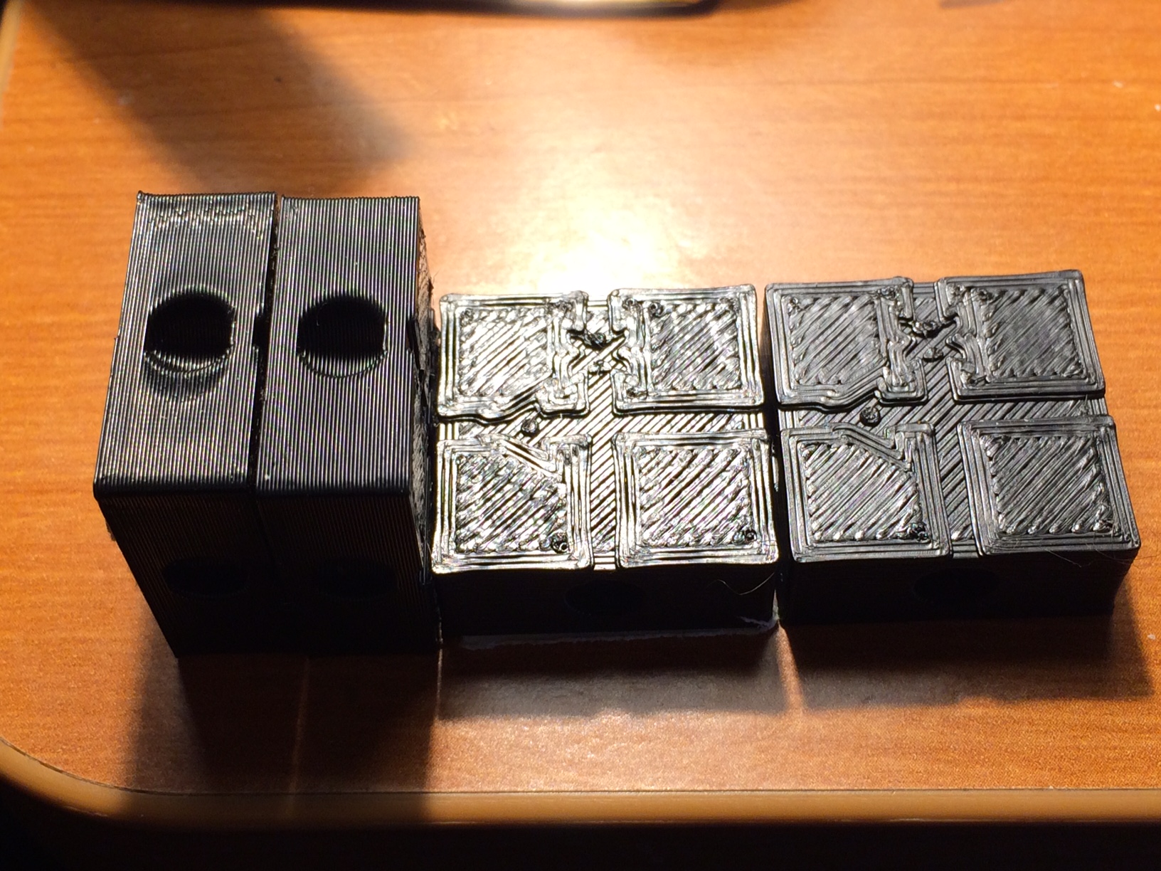

I tried a little test part today in an effort to figure out some settings for improved print quality. I set XY accelerations to 100. I got bad flaring in the part at any direction change - so i started messing with extruder acceleration.
I didn't get close to a flat part until extruder accel was set to 1 (XY still at 100). Extruder at 1 and XY at 200 looked almost perfect. I'm running ABS with a .5mm nozzle, fwiw. I also find it interesting that the low setting for extruder accel increased the build time significantly. With accels this low I'm getting very long times for a small part, but I'm just starting out and will be looking for upper limits where ringing starts to be an issue. With higher extruder accelerations the build time for my little test cube was 40 minutes. With the Extruder accel at 1 it took 66 minutes.
The improvement in print quality, however, is astounding. Based on what I'm learning with this exercise, I think I'll have to go back and reestablish all my baseline settings. At this point I'm dealing with unacceptable build times, but I'm sure there's a lot of room for improvement in that regard.
If you've messed with Extruder acceleration settings, what did you learn?
I'm going to continue to explore this and will share what I learn.
The Vertical and Horizontal blocks to the left were with high extruder accel values. The blocks to the right were both printed with extruder accel of 1.
All parts were printed with XY accels set to 100, jerk 10, speed 5200 (but it never gets there because the accelerations are so low).

i haven't really confirmed this yet, but based on what I'm seeing in my test prints and machine operation, I believe the XY motion is not allowed to over-run the extruder, but the reverse is not true - the extruder can over-run the XY motion.
It seems reducing your extruder acceleration and jerk settings will impact overall print speed and prevent over-extrusion at the perimeters of solid fills and narrow, which I have always seen in my prints. XY Jerk settings do noticeable impact motion when the accelerations are low.
