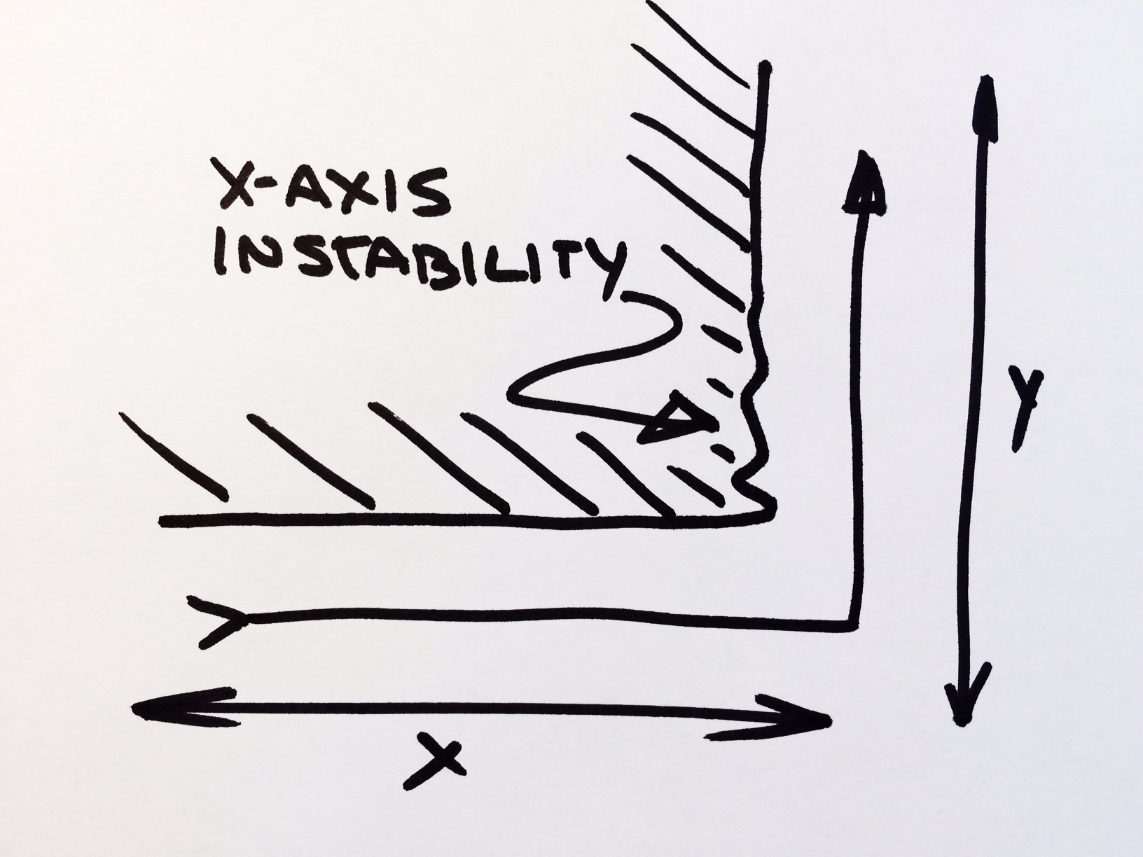

1) One of the first things I did with my M2 was install dampers on the X&Y motors. I was concerned that reducing the rigidity of the gantry drives by adding the elastic element would result in increased ringing. I expected an increase in the magnitude or a decrease in the frequency of the ringing artifacts, but I saw neither in my before and after test prints. I could not see any difference resulting from the change to the mechanical properties of the drives.
2) A while back i was running some test prints in an effort to optimize acceleration settings. At one point I set the X-axis speed and accel very low while leaving the Y axis high. The expectation was that ringing on the Y axis of the print would be impacted by changes to the dynamics of the X-Axis.
What I found, however, was that changing the dynamics of the X-Axis movements had no impact on artifacts on the Y-face, but rather smoothed out the printing in the X-direction.

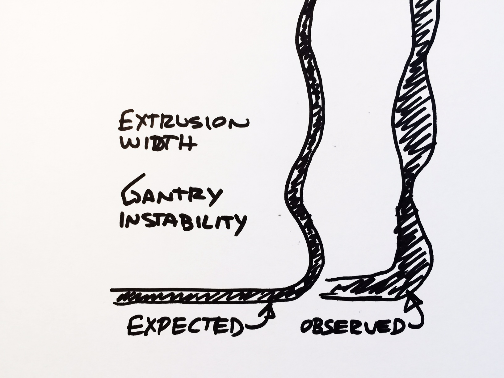

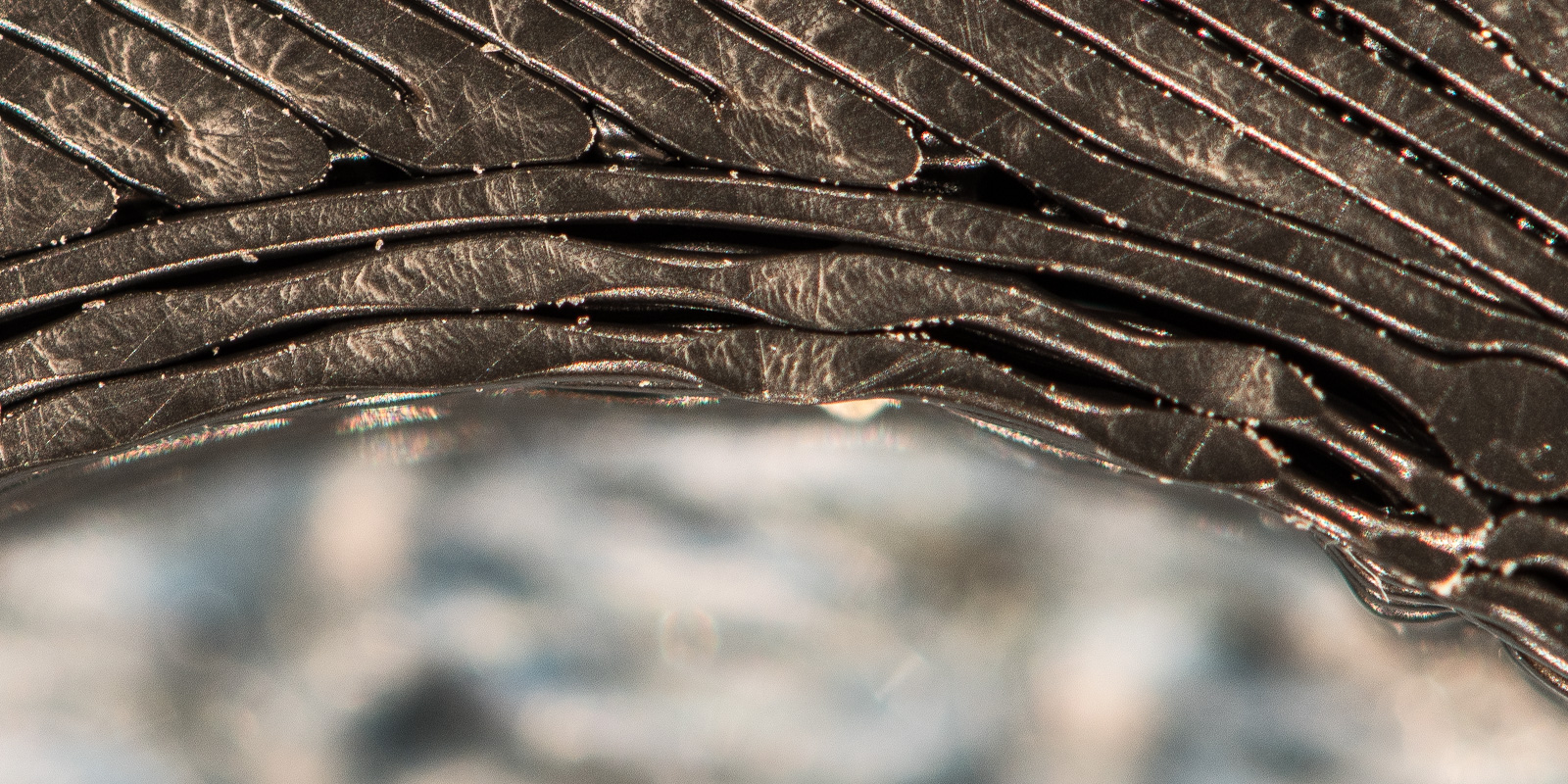

3) If ringing is due to the dynamics of the X and Y axes, one would expect the plastic extrusion to be a wavy line with constant width where ringing is occurring. Close inspection of many prints has show that the extrusion width varies along a fairly stable path. To me, this is an indication that the linear movements and the movements of the extruder drive are stair-stepping their speeds at different points resulting in variation of the extrusion width.

I'm an M2 user but lately I'm commissioning a scratch-built large-format machine, and have been banging my head against a wall with some heretofore unseen artifacts. After weeks of eliminating potential causes, one of the only things I left left to look into is the extruder acceleration and jerk, which I never considered important before.
One of the issues is the variation in extrusion width that you've captured so well. BTW, if I didn't know any better I would say you took that with a telecentric lens, like one would have on an optical inspection system (?).

Thank you. I am a part-time professional photographer and have some good gear. I used a 105mm macro lens for that shot, and may have added some extension tube to get closer. I don't recall the details.
