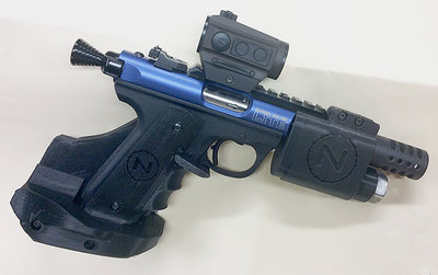

This thing is a bit over the top. :lol:
This is the 22/45 LITE model, which is a bit too light for singlehanded Bullseye shooting. So I fabbed up the funky holder in the front for a .5" x 3" stainless steel bolt for the barrel weight. (Cool fact: the there are actually printed threads in there, so the bolt screws in) Now it weighs about as much as a stainless framed target Ruger. It has about every upgrade from Volquartsen or TandemKross installed and is in general, not a bad pistol.
The front weight makes it barrel heavy, but the orthopedic grips keep your hand nestled in place, so you don't notice it. The recoil is definitely more muted, so you can get back on target for timed and rapid fire stages.
The compensator looks cool, but I took it off as it actually hampered accuracy. I only used this pistol for a few months before upgrading, so it sits in the safe now as a potential sale or trade in the future.
@NavyDT, thanks for the compliment, this project was not finished by graceful waves of my hand over the keyboard, but by ramming my head against it hard enough! That's how I get the job done! :lol:
The testing and fitting to get to here took about a month and a half to do and an entire filament roll of prototype prints and then some. The fitting to the gun was not easy, the fitting and design of the sliding palm rest and the dovetail locking joints that hold the finger grip on took forever. It is easier to see the major parts relationships in my previous post as the parts are colored differently for clarity.
However, the fitting to my HAND made the other fittings look like a walk in the park. Every week, for 6 weeks, design, print, shoot, rework, design a new part, print, test fit the new part interactions, reprint, shoot, rework two parts, design a new part , print, test fit the interactions, reprint, shoot, rework three parts, design a new part, print,shoot, over and over and over and over andnovoerjnaououenoufasf--aaaaarrrrrrghhhh!!!!!. WHEW!
