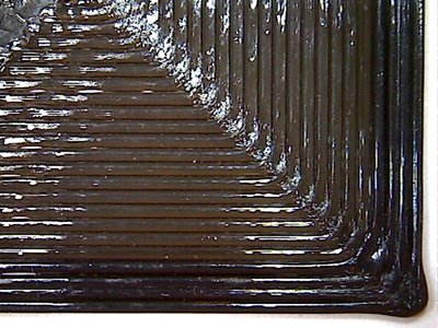

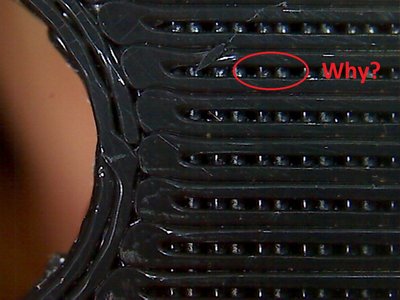

Hello,
Looking at the attached picture, is it possible for someone to tell me what may be going on with the printer to cause the gaps between the plastic strings?
Thanks.

Is that the bottom of your first layer? If so your z-height needs to be lowered. (less gap)

If you're doing standard 45,-45 infill and your concern is the part you have circled there, that's almost certainly backlash. Both axes change directions on the alternating lines there, and any backlash means X or Y doesn't move the full distance on a direction change. For instance, if there's 0.1mm backlash in X, you can think of it as lines moving X+ being shifted 0.05mm to X-, and lines moving X- being shifted 0.05mm X+. And voila, you get lines that are alternately too close and too far apart.
Typical sources of backlash are loose belts, loose screws holding motors, belt clamps, or anything else that moves. A loose glass plate would also look like backlash on fast infill, since the plate would keep sliding after the axis stopped. More rare is a belt clamp that's a loose fit for the belt, which can be fixed by putting a shim behind the belt to shove the teeth more into the grooves on the belt clamp.

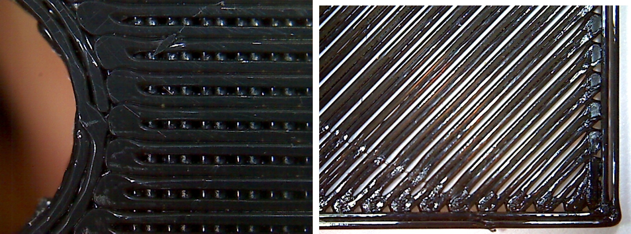

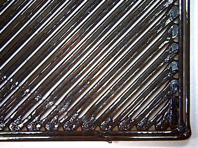

I decided to experiment a little more by printing two small squares, in one of the square I set the "External Fill Patter" to "Rectilinear" and the other square to "Concentric". I then printed the first layer and looked at the results. Turns out that the square with the rectilinear pattern (45 / -45 angle) had the issue with the gaps while the square with the concentric pattern was pretty much perfect.
Based on those findings, your backlash theory (something loose) makes scenes (at least it makes scene to me at the moment). The problem now is going to be figuring out what is loose, everything seems to be nice and tight but its impossible to tell by feel (given the tolerances we are talking about here) if something is loose or not.
The printer is brand new by the way (two months old) and only two spools of PLA under its belt so wear and tear should be out of the question. Are there any video / instructions on how to reset the printer belts / steppers etc?
UPDATE: See attached Rectilinear and Concentric photos.

Thank you, sounds good, however, just a couple of quick questions if you guys don't mind:
1) How will lowering the z-height address the funky layer pattern? If you notice in the picture from my first post, the pattern goes something like "filament line" -> "filament line" -> "gap" -> "filament line" -> "filament line" -> "gap". Is this really the type of pattern that you would expect to get from an incorrect z-height?
2) In a different post, I show the exact same object first layer printed with concentric and rectilinear patters, if this was a z-height issue, why would one pattern display the issue while the other does not?
3) How do I lower the z-height so I can test the theory?
Thanks.

I would use S3D to decrease the z-height. Under the G-Code tab is a box called Global G-Code Offsets. Decrease the Z-Axis to some negative value to start printing with the extruder closer to the bed.
