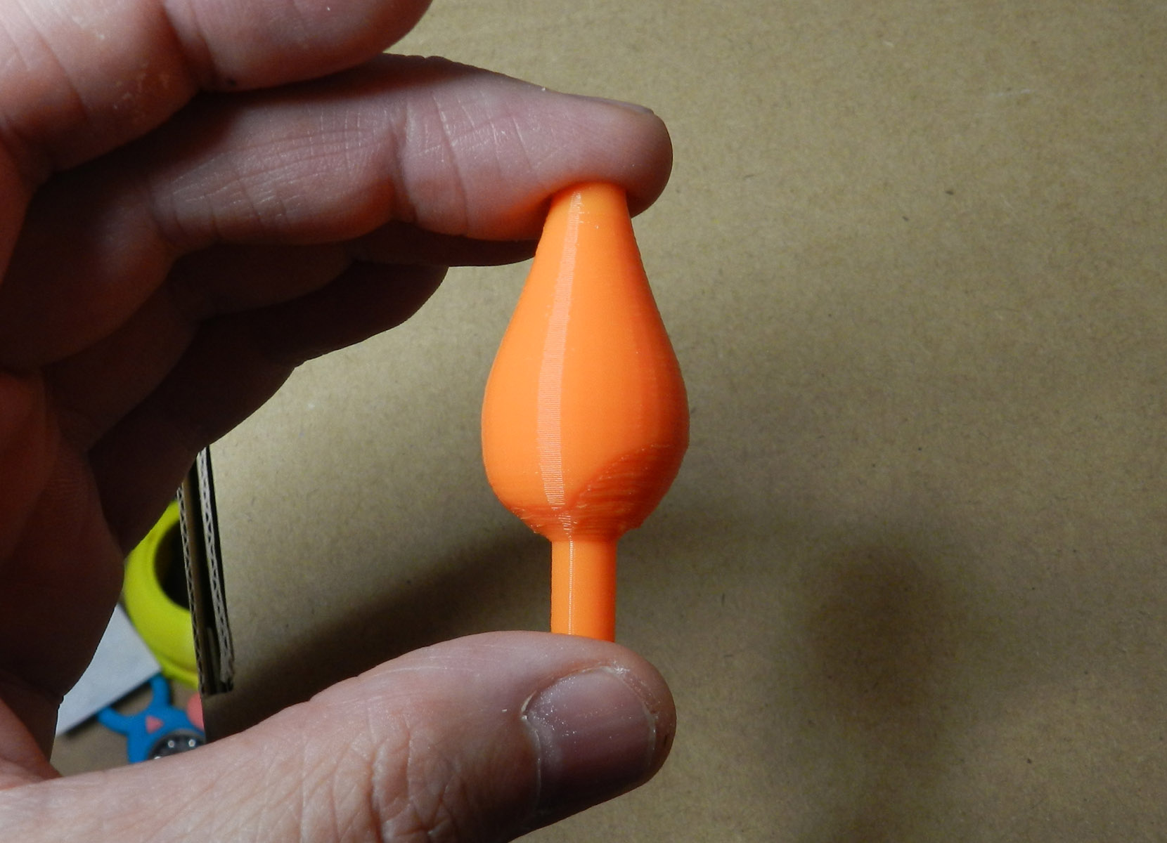

Looking for an elegant solution to getting more cooling on the back side of prints. In the photo below, the front of the printer is on the left. The back side of the print (on the right) gets much less cooling and as a result, is much less smooth. I've seen posts where some suggest putting a desk fan blowing in from the back, but am looking for a more integrated solution. I do use a fan shroud that directs more airflow from the front, but it doesn't do anything for the back.

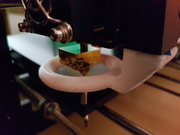

In an attempt to address this problem, I mounted a fan behind the printer facing the nozzle. It improved the back of the print markedly, but it also degraded the front. It seems the competing air pressures reduced the amount of fan blowing from the front. I've reviewed the modification section and there are some promising shroud designs, but they are for a different hotend. I also searched Thingiverse, but I'm already using one of the more popular M2 shrouds.
Does anyone of something like the pic below for the V4 Hotend?
