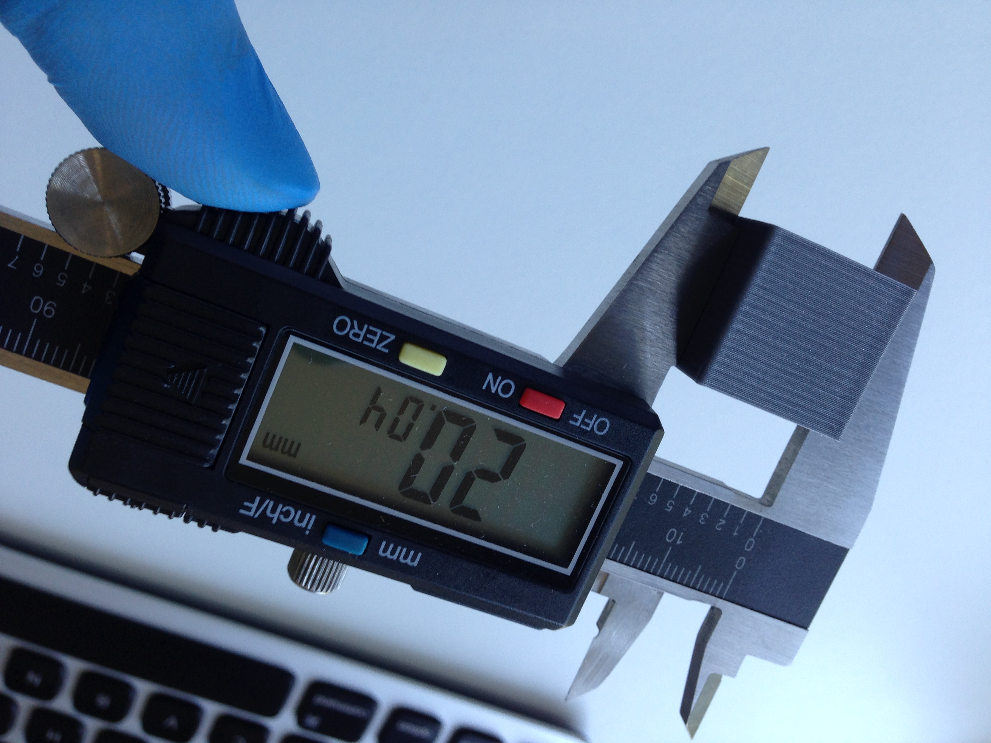

I've been printing to some 20mm calibration cubes to see what kind of accuracy I'm getting out of my M2 Rev. E. The following settings were used:
Material: Hatchbox PLA, Silver
Extruder Temp: 200C
Bed Temp: 60C on Buildtak
Print Speed: 60mm/s with 50% underspeed for perimeters and solid infill (fastest I can print without warping).
Retraction: Default S3D retraction settings for PLA
Slicer: Simplify 3D
Nozzle: Standard 0.35mm (Brass)
Cooling Fan: ON @ 100%
So far, the best cal. cube dimensions I've got out of the M2 are 20.4 x 20.21 x 19.94 mm (x, y, z). Makergear states that the steppers are accurate within 1/80th of a mm, which would be 0.0125 mm. I'm not sure how this translates into dimensional accuracy for printed objects, but it would appear the calibration cubes I'm printing aren't within spec. Members of this forum have posted that commercial machines like the M2 have printed, dimensional tolerances no greater than +/- 0.20 mm. I guess my questions are:

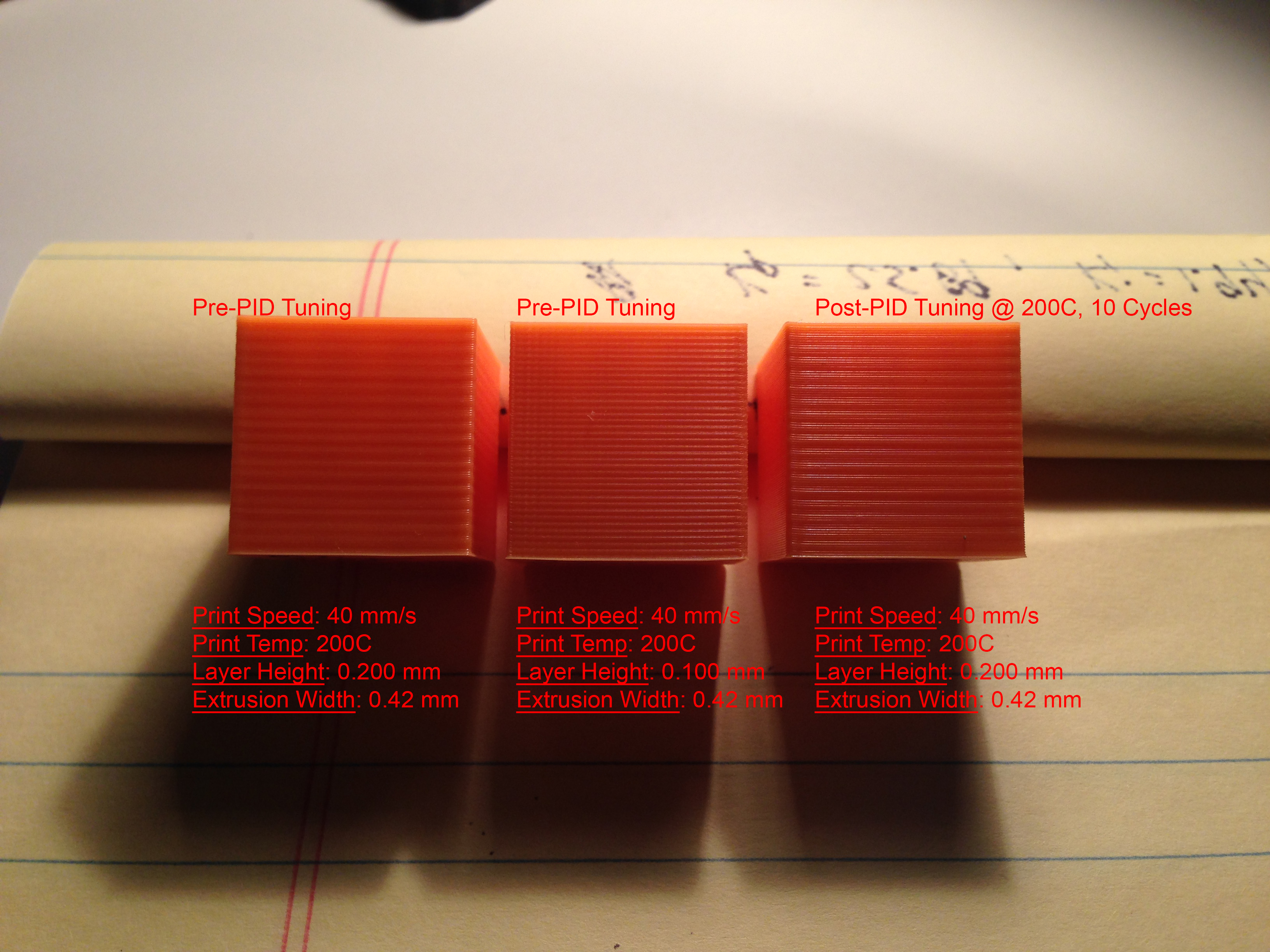

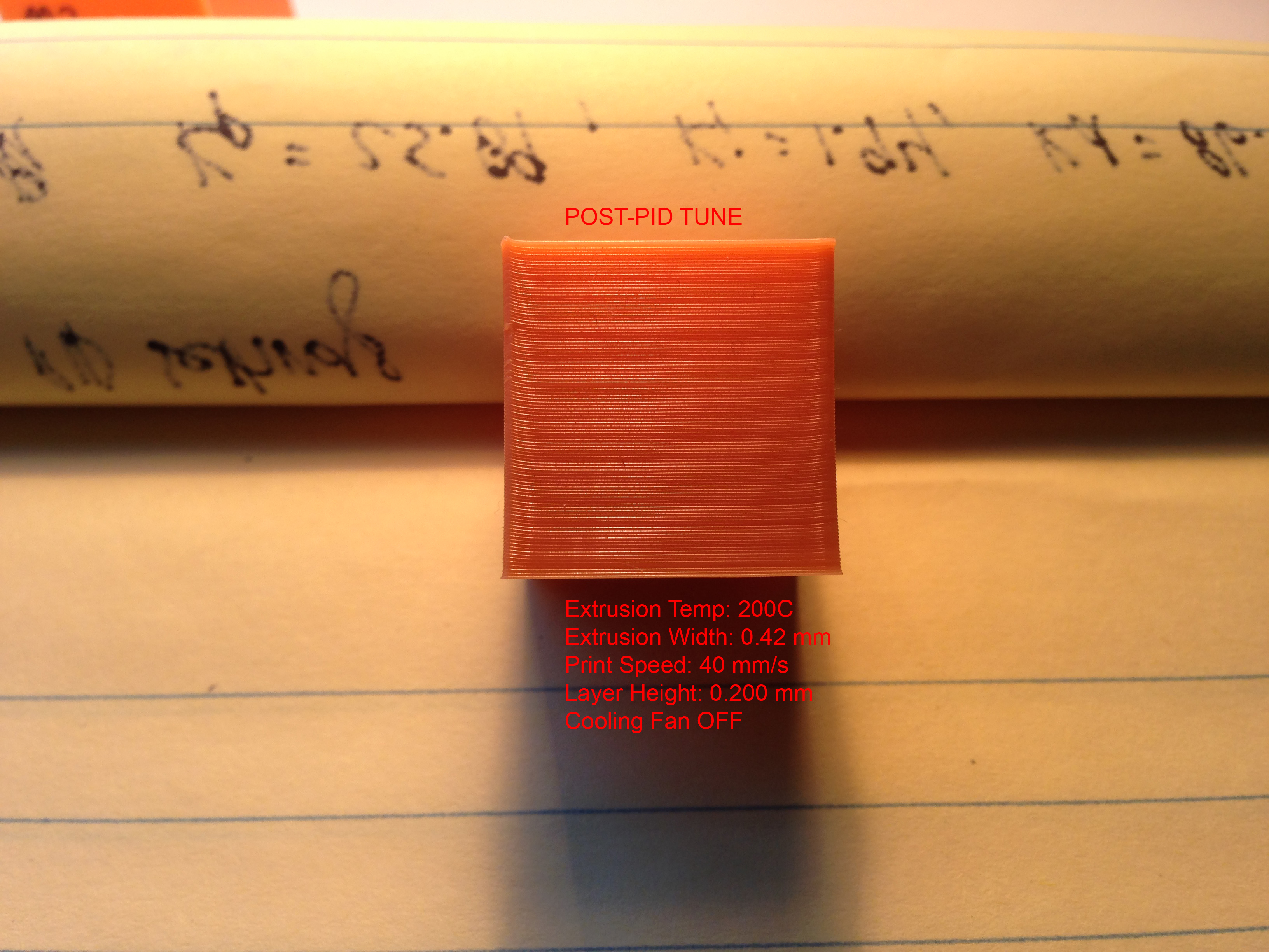

Post by BBID » Sun Jul 16, 2017 3:40 am
For those of you that are interested, I was able to get a little better dimensional accuracy in the calibration cube by adjusting my extrusion multiplier till I was getting exactly the extrusion width I was specifying in S3D. The thing that's driving me insane now is trying to get rid of those lines in the print walls. I've tried everything: ran PID autotune, tried turning the cooling fan off, tried changing layer height, tried increasing print speed to 80 mm/s (which just produces warped prints)....nothing works. I've reached out to Makergear for a solution and hopefully they'll get back to me next week.
I really am getting frustrated with the M2. I thought with a little tuning this machine would produce much better prints. While I would agree that no FDM printer produces perfect prints, I have printed cal cubes on a Flashforge Creator Pro, Ultimaker 3, and a Markforged Mark II, and have seen that they produce excellent quality prints at much faster speeds. With this in mind, I have adjusted my expectations for the M2 accordingly. The M2 is appears to be capped at 40 mm/s for PLA if you want useable prints. Have other users experienced a similar limitation?
