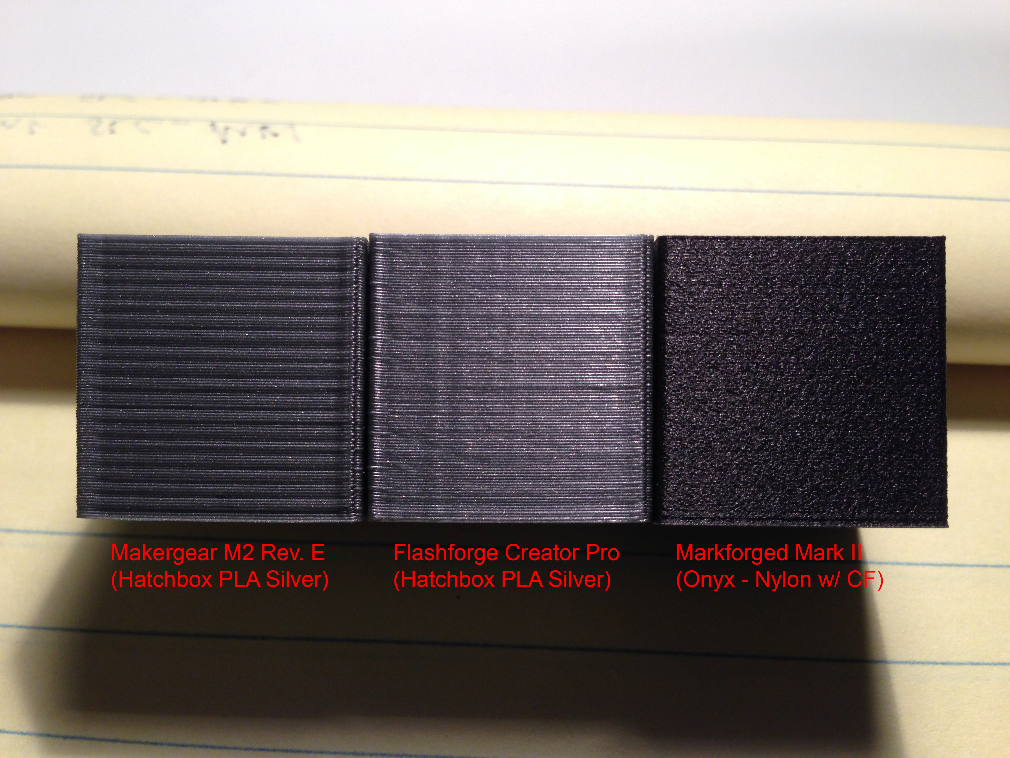

I took your advice and printed four cubes at once. The lines are still there, but like the 0.100 mm (z-res) print I ran, there are more of them and they are closer together. I'm still waiting for Makergear support to get back to me on this problem. I am currently running calibration cube prints are two other printers, each made by a different manufacturer, to see if this issue is typical for the FDM process on all commercial FDM printers, or if it's just showing up on the M2. I'll post back when I get more info.

1. I'm using Simplify 3D for the Makergear M2 Rev. E, Flashforge Creator Pro, and the Ultimaker 3, but Eiger.io (Markforged's proprietary cloud-based slicer) for the Markforged Mark II.
2. My M2 Rev.E's z-nut is black, not brass. I'm assuming this is the latest iteration of this z-nut for the M2?
3. M503 output for my M2 Rev. E:

The quality and accuracy of the Mark II print is unbelievable. Dimensions are dead on, no PID lines, solid horizontal surfaces are completely flat, strength of parts is astounding. I can't even find the print seam/zipper on most parts. I can upload pics of the Ultimaker 3 print later...although its looks very, very similar to the Flashforge Creator Pro print.

Yeah, the black nut is one thing I'm not a huge fan of -- because of this part of your M503 output: Z1007.70. It is imperial threading (1/8in per turn), but the firmware is metric. This causes a nasty 25.4 error, which microstepping can't entirely fix. The brass nut (no longer available for various reasons) uses a clean 400 steps per millimeter. "Round number" layer heights get even numbers of full steps. With a decimal step-per-millimeter number, there is no easy way for the firmware to divide it by a round-number layer height, and you'll get step errors piling up every dozenish layers.
Try "0.1905" as your layer height. That cleanly divides.

I must say, I'm jealous of the Flashforge results. My M2E is probably somewhere between your M2 and the Flashforge, but I'm still tuning things. The Markforge is amazingly good, but with a custom slicer and a $13.5K price tag, you'd expect that.
To add insult to injury, the Flashforge cost $1k less and printed that cube at 80mm/s, twice the speed of the M2. If Makergear would add a proper blower-type cooling fan to their machines, their printers would most likely surpass the Flashforge in terms of speed and quality.
That quality can be had for much cheaper, the Markforged Onyx One is $3500 IIRC.
I'll give this a try, but I'm not sure what 0.1905mm cleanly divides into...1007.70 steps/mm? To lower the build platform one layer height would require 191.96 steps, another decimal step amount. I'm confused. :?

"Try "0.1905" as your layer height. That cleanly divides."
I also got 101.96. I did some math and got to .1905329 which was good to 5 decimal places (theoretically).
I realize 1/10 millionth of a millimeter accuracy is too much to ask. Are you saying that .1905 is close enough?

it's more that the firmware won't care after a certain precision. i don't know what it is, but .1905 will be close enough :)

It looks great but a couple of things.
1) You need to use similar filaments when comparing look. CF looks amazing in general - there are a couple of screenshots of CF prints on the M2 and they look great.
2) You have something screwy with your settings on the M2 you shouldn't be seeing lines like that - certainly I don't.
This is a print I did yesterday with some ratty old PLA to test the variable layers in the new S3D. I did thisa at 75mm/s it goes from 3mm -> 2mm -> 1mm . It has some ringing there that I wish I could get rid of.
The CF print from the Markforged printer was just to show what a commercial desktop printer is capable of. Some users were suggesting that the perimeter lines were inherent to the FDM process no matter what printer you use. If you want me to use the exact same filament, slicer, infill settings, layer height, etc....look at my Flashforge calibration cube prints. I think I made my point that this issue is specific to the M2, although I haven't figured out exactly whats causing it. I contacted Makergear on July 9th about this. They've asked for a couple bits of info on my slicer settings and my g-code, but I haven't heard back from them for a week.
This is exactly what I was worried about and what I've been trying to convey to Makergear.
I don't know how you got that print at 75 mm/s without warping, but my M2 Rev. E can't print PLA faster than 40 mm/s with a 50% underspeed on the outermost perimeter if I want the print to be even remotely accurate.
