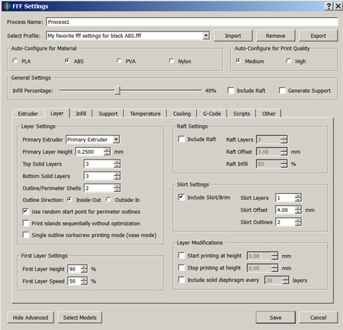

The image is an example of what caused me to begin this thread.
If I change anything, for example skirt offset, then click "SAVE", is my favorite fff file changed?
If instead, I click "EXPORT" then name it "Favorite with no skirt offset", what happens?
Gary

Lateralg wrote: It's clear that I need to learn more about S3D. For example, I've never used a Process to save settings. I'm unclear on what the advantages are.
If you click Export then the file will be saved to disk, where it will not be affected by anything else you do unless you overwrite it with another Export. The advantage of that is that now you have your settings permanently saved on disk so you can reload them any time you want with "Import."
If you click "save", or just hit return and it takes you back to the main S3D window, then those settings are the ones currently in use when you slice, and S3D will load them again if you click "Add" under the process window. this is true across sessions, so that the last set of process settings will be the one loaded when you start a new process. This is supposed to be a convenience I guess, but personally I just find it confusing. Who knows what little tweak I did the last time I was testing something and then forgot about it? My practice is to totally ignore any settings that are there when I first add a process, and either load one from disk with "Import" or....
