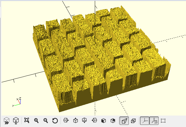

OpenSCAD has a Surface function that may be of interest.
I just did a quick Google image search for "brick heightmap"
Obviously not the ideal map but just as a starting point to give you an idea:
produces:
Code: Select all
surface(file="brick.png", center=true, convexity=5);
%translate([0,0,2]) cube([100,100,1], center=true);
