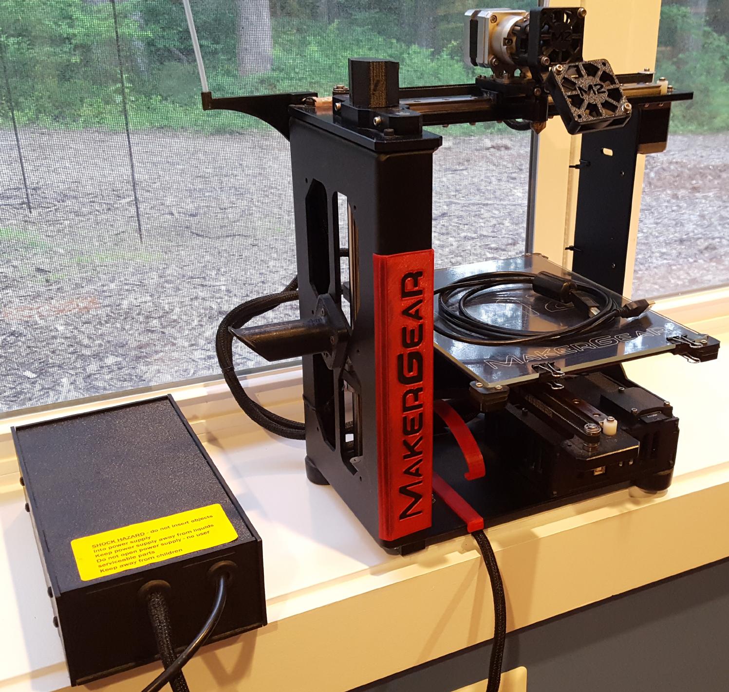

I just wanted to share a little testimonial here. . .
The photo is of a MakerGear M2 that I bought second-hand and donated to the local high school (Poolesville), which has an excellent science and math magnet program that I felt ought to be teaching kids about 3D printing technology on a regular basis.
I donated this printer over two years ago. Being used as part of a STEM curriculum, it does not stay in a closet. Being at a high school, it gets much abused by kids just learning the ropes about 3D printers, over and over again.
I took this picture yesterday. It looks exactly like the day I gave it to them. The reason that I had the printer at home was because I was repairing it after it walked itself off a table and dropped four feet to the floor. Honestly, you cannot tell that it got dropped from a height onto a hard floor, not that I would recommend doing it. The only visible damage is that the Z-knob got dented on top. I had to replace the hot-end, which snapped at its weak point, and the extruder fan, which looked like it had taken the brunt of the impact, cracking into pieces (being an M2 hobbyist, of course I had a spare hot-end and fan lying around). I had to hammer the motor mount back to a 90-degree angle. The electronics box had popped apart but wasn't broken. I carefully cleaned everything and put it back together, plugged it in and ran it through the paces. Everything worked perfectly, just needed tuning and leveling, and I delivered it back to the school 24 hours after picking it up.
Honestly, the M2 is indestructible.
---Tim
