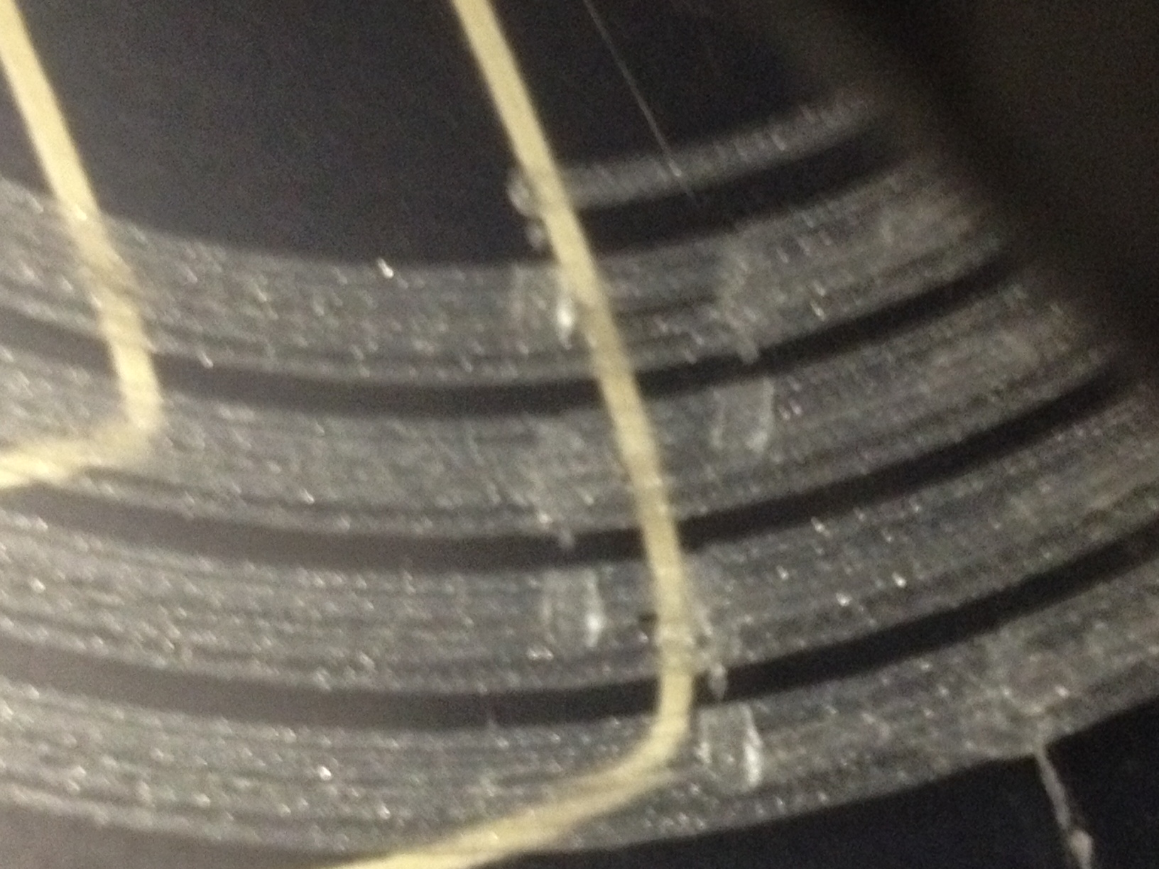

I am running into a number of issues with a very difficult print. I have tried printing this - http://www.thingiverse.com/thing:19304 - more times than I care to admit. I am getting stringing as well as the printer nozzle dragging through the end of a layer causing small divots in the layer. I have tried a number of things to avoid this including temperature, retraction, extrusion multiplier, "force retraction between layer" on S3D. Does anyone have any advice for how to get this to print properly? I would greatly appreciate any tips you might have.
I am printing with:
Extruder 215C
Bed 60C
Extrusion multipler .90, Extrustion width auto (0.48), retraction distance 1.6, extra restart -0.02, retraction speed 3000, Coasting distance 1.4 mm
Ultimachine Silver PLA
(562.69 KiB) Downloaded 1109 times
(706.31 KiB) Downloaded 1109 times
Posts: 1863
Re: Stringing and nozzle dragging on layers
Post by jsc » Fri Apr 25, 2014 8:55 pm
Did you set z-lift on retraction? Try setting it to one or two layer heights worth.

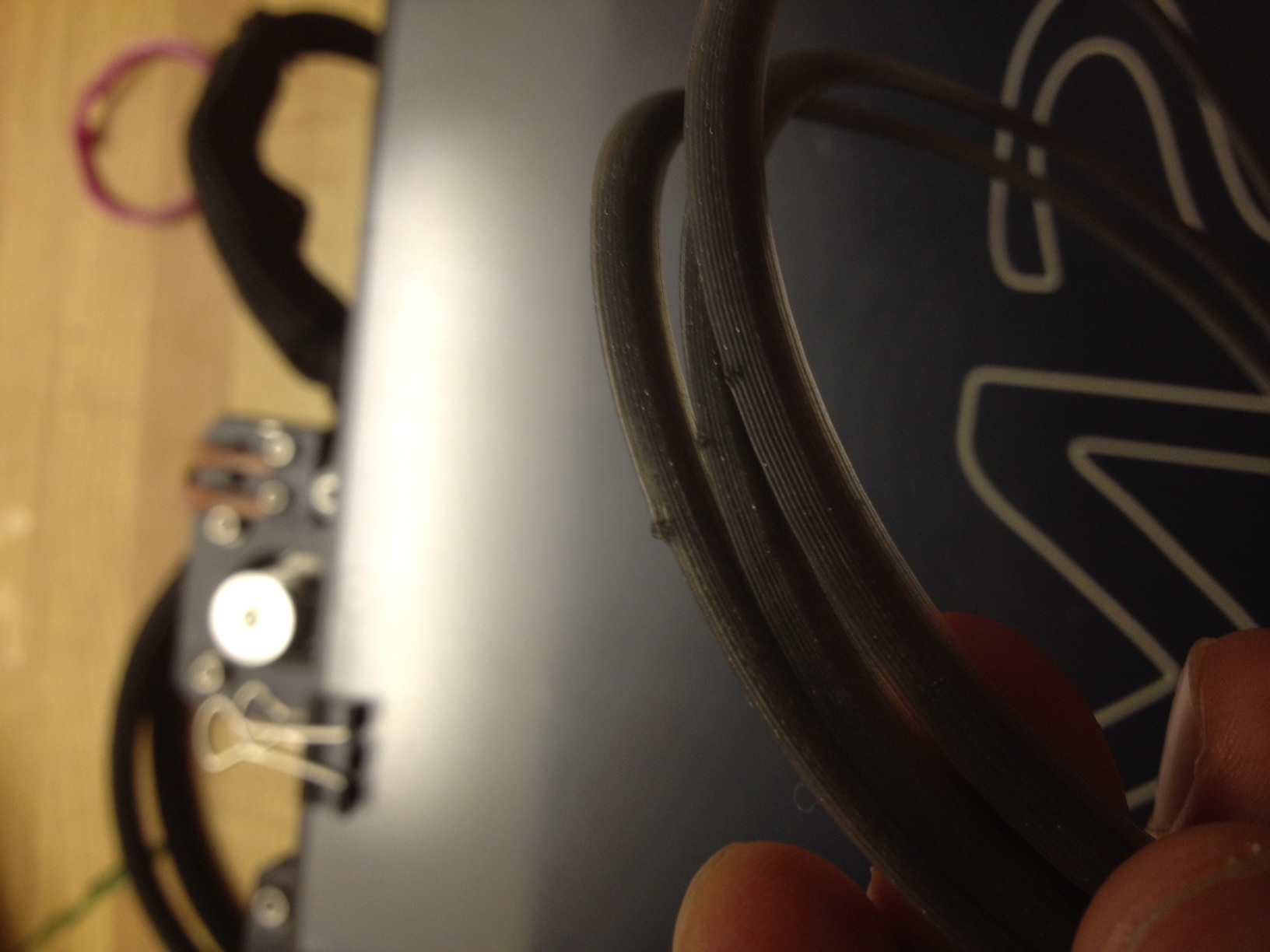

The begining/end of the layers seem to protrude way out from the rest of the print as well.They are nowhere near smooth transitions between layers.
(393.37 KiB) Downloaded 1101 times
Posts: 1863
Post by jsc » Fri Apr 25, 2014 9:39 pm
If you want the nozzle not to drag through your layers, set the retraction vertical lift. You can use multiple processes to change things up at different heights, it's covered in one of the Simplify3D tutorials, but if I set it I generally set it for the whole object.
Your layer start/end issue can be improved by messing with coast and extra restart. Try upping your extra restart; I see you are using -0.02. Ultimately, I think that derives from a Google forums post where jimc suggested some parameters and misplaced the decimal point. Try -0.2.

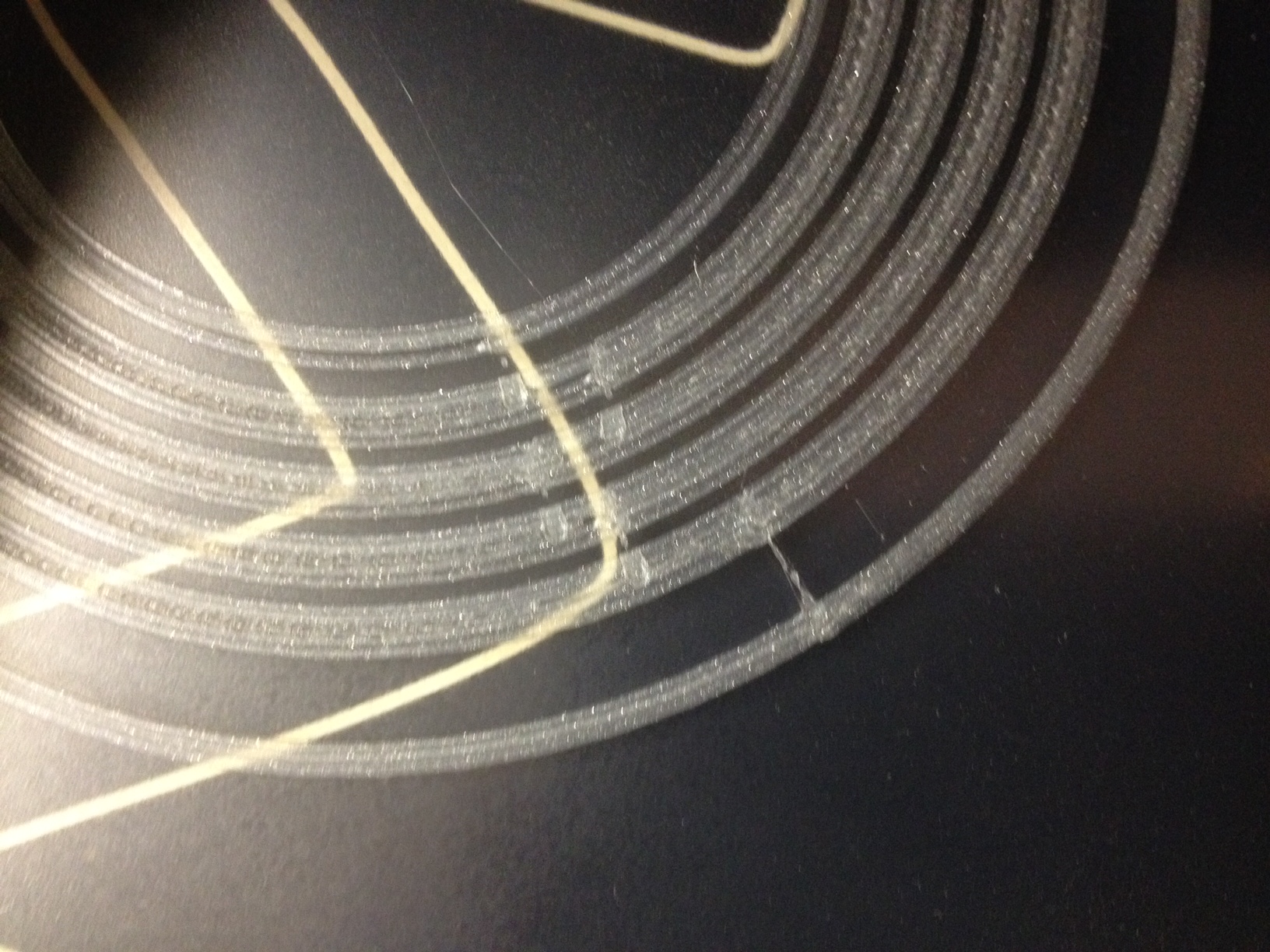

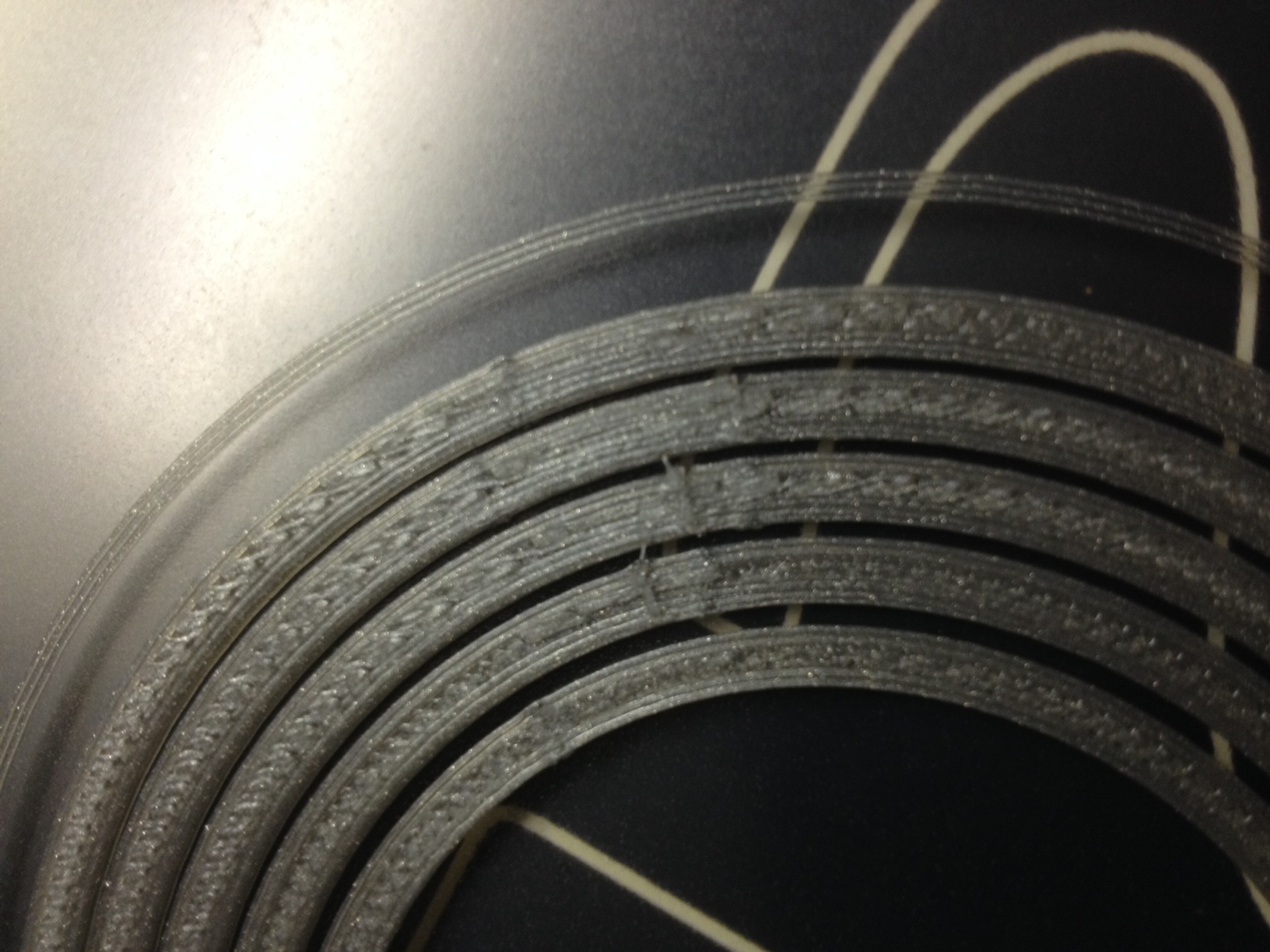

I have set my retraction far beyond 1.5 and still get these strings. They are always in the same spot. The thing I don't understand is that they don't appear in my geode preview, but they print there regardless of how high I set retraction settings. The printer seems to treat it like it is continuing a layer while it jumps from one ring to another (see photo). Any other ideas?
(519.63 KiB) Downloaded 1047 times
Posts: 1863
Post by jsc » Sun May 04, 2014 3:15 am
In the Advanced tab, make sure you have Minimum travel for retraction turned off. That will enforce retraction even for very short moves.
And definitely check your extruder gear for a loose set screw. That is a common issue. If you have an unresolved mechanical issue, you can chase settings forever and never get results.
