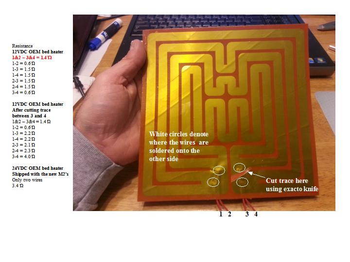

2. Cut the copper trace as shown in the photo using an exacto knife. Be careful to not cut all the way through the rubber.

4. Check the resistance between wires 3 and 4. It should be between 3 and 4 ohms.
5. Cut wires 1 and 2 short and put some heat shrink over them to keep them from shorting onto metal surfaces.
Understanding how the old bed is wired
