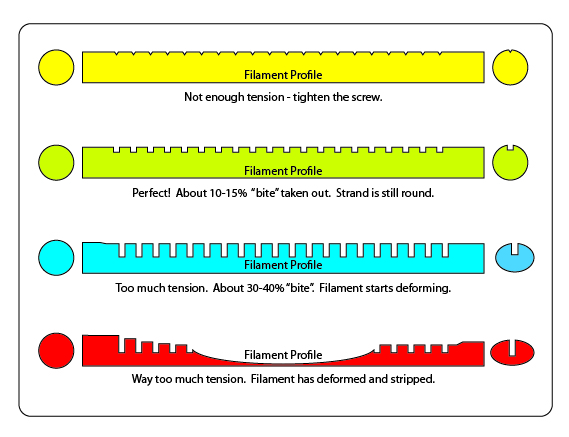

What you can do, is have a bit of fun playing Sherlock ( :P ) by examining the end of the filament that goes into the drive, and make adjustments based on what you see after you retract the filament completely.
Since a picture is worth a thousand words:
Filament Drive Screw Tension.jpg (707.05 KiB) Viewed 44817 times
Both the first and the last conditions on the chart are preceded by no filament coming out. :shock: But if you have been printing along happily and you suddenly have nothing extruding, (accompanied by a thunking sound),it's a stone cold bet that your filament diameter has swung up and you've stripped it. Retract the filament, and re-measure the diameter. Look at the tooth marks and loosen the tension if needed. (You will probably want to cut the over-sized length out of the spool.) On the other hand, if you are loading it and it doesn't feed, but comes out easily when lightly tugged at the top, that's an indication that the screw might need to be tightened a touch. In any case, it is always safer (from a non-jamming standpoint) to reverse the filament out and look at the end before you tighten that screw. Deep tooth marks are a no-no.

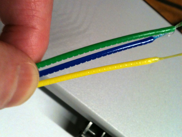

This is what you are shooting for. These are PLA, but you want about the same "bite marks" on whatever filament you are printing. That's going to mean adjusting the tension when you switch from one kind of filament to another, PLA to PETG for example, or any of the softer filaments. (And even though it doesn't necessarily belong here - remember that the softer the filament, the slower you print/extrude it.) 8-)
Filament Ends.jpg (228.2 KiB) Viewed 44817 times

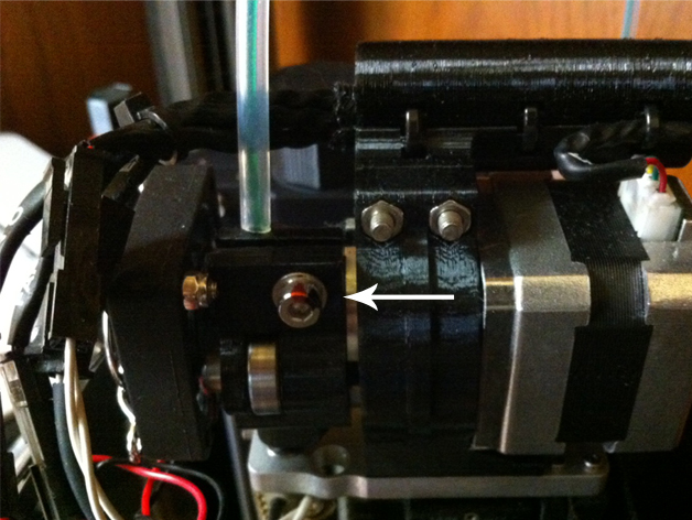

Tip Update: I jump back and forth between PLA and PETG on a regular basis, and i was getting a little tired of having to adjust that tension screw. Sometimes i'd completely miss the mark and wind up having to go through several iterations to get it reset correctly. One of the guys had mentioned making a mark on the bearing to see if it was turning on another post, and I decided to put that idea to use for the tension screw as well. It's a tremendous time saver......
Once you have the tension set correctly for a particular filament, make a mark on the 12:00 position of the screw. For mine, PLA is marked in black Sharpie marker (not very neatly, but i'll fix it later). So anytime i'm printing PLA, i make sure that the black mark is in the vertical position on the screw.
PETG is marked on my screw in red Sharpie, so when i print PETG, i make sure the red mark is up at the top.
That's it, and it's super easy. Notice how close together the two marks are - you don't have to tighten things up much when you switch to a different filament. But that tiny bit of turning can make all the difference.
PETG being printed 'cause the red mark is on top.
Screw modification.jpg (230.3 KiB) Viewed 44673 times
