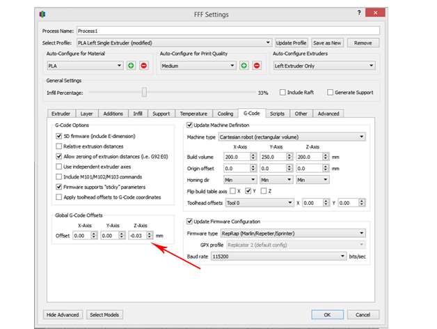

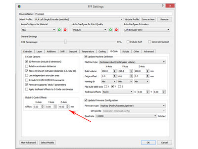

In the G-Code section of the printing parameters in S3D, there is a Global Z-Offset slot. (There is also a Z-offset in Slic3r that should work the same way.)

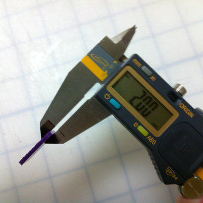

2. Measure the height of the printed square with calipers, (as accurately as possible), subtract the measurement from 2.0 mm and then enter that resultant number into the Z-Offset slot in your profile. (If the square is not tall enough, you'd enter a positive number, if it's too tall, you'll add a negative adjustment.) A positive number in the Global Z-Offset slot moves the bed farther away from the starting point for the first layer, so that the thread gets laid down evenly instead of getting squished out. A negative Z-Offset adjustment number brings the bed in closer before printing, so that the thread can stick to the plate with the correct bonding ratio.
I generally run a second and maybe third square, just to fine-tune it, until I get a square exactly 2.0 mm tall.
