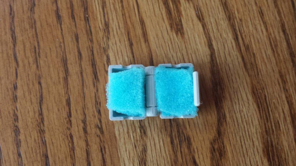

From Toby:
There is evidence to suggest that dust can accumulate on unused filament and eventually make its way into the nozzle during printing. This can cause the filament to extrude in a distorted way and mar the print, or in extreme cases, lead to clogging and no extrusion at all.
Fortunately this problem can be solved by a simple DIY technique of placing a dust trap physically around the filament before it enters the tube on the way to the nozzle. Here is a picture of one such setup:
In this case the wrapping is made of a lint free wipe and secured with a cable tie This brand is Kimwipes and is available cheaply at Amazon here: http://www.amazon.com/gp/product/B0013H ... UTF8&psc=1
Others have reported success using a paper towel or a small piece of ethylene foam with a hole poked through it by the smallest Allen wrench that comes with the M2.

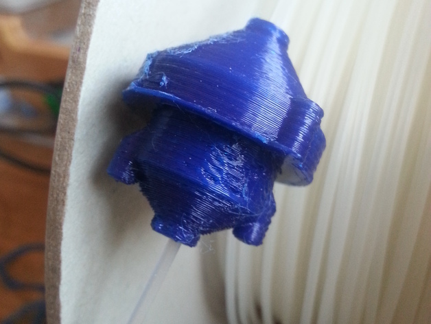

Found this as a slightly fancier filament dust remover you can print yourself http://www.thingiverse.com/thing:302235/#files
filament dust cleaner.jpg (98.18 KiB) Viewed 105434 times
