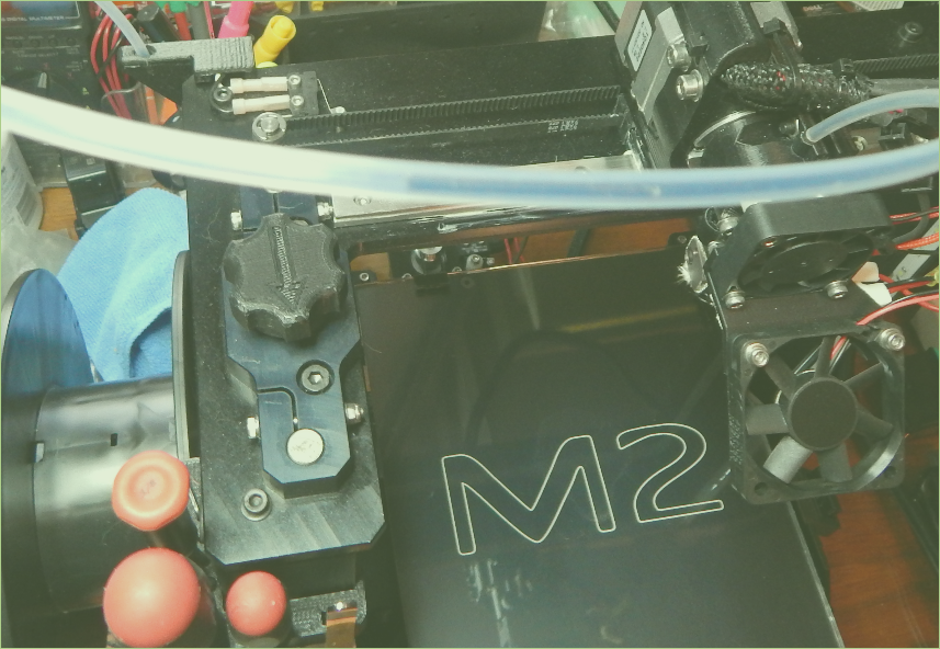

I rely on blind dumb luck. I ran a print overnight, came back to my M2 the next morning with a successful print and THIS left in the filament feed tube:
What was left in the filament feed tube when print finished!
Note the empty spool on the left...
