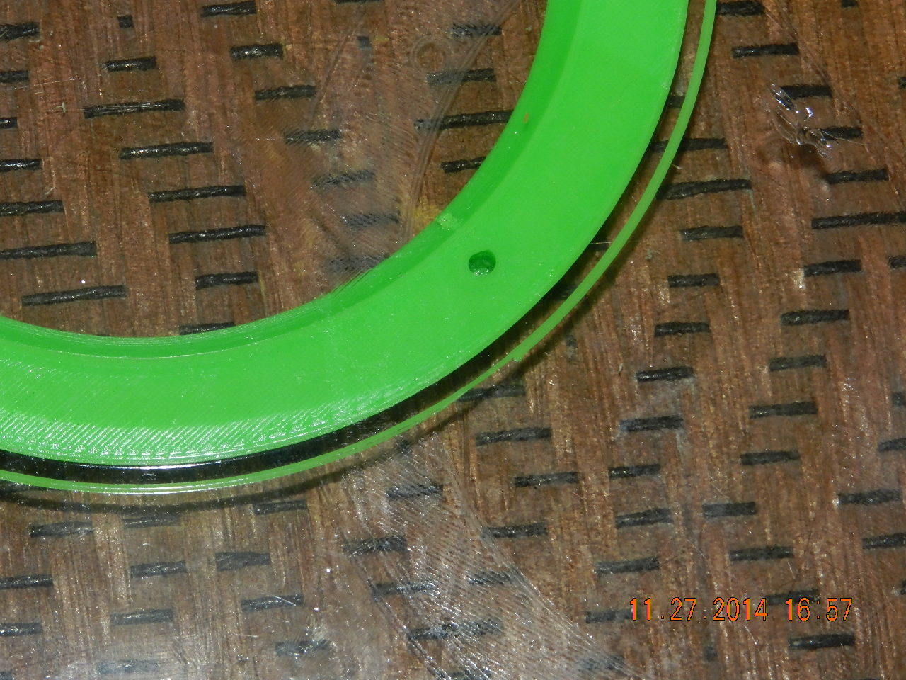

This pic was shot thru the bottom of the glass build plate printing in ABS.
Only .001" shrink up from the plate, making a flat finished bottom.
You'll also notice a shadows of a former prints in the hair spray foot print.
