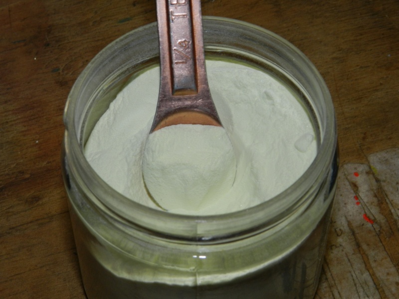

Change colors, particulate grind colorant and how the filament is produced has a lot to do with success.
Below is the glow powder used to make master batch glow for injection molding:
Filament colorants must be a fine-fine powder and not the average run of the mill colorants I use
in my injection molding tools to make fishing tackle out of polycarb.
My M2 does not, or will not print glow without a bunch of messing around/fine tuning I do not
have to do with other colors. Going to order large nozzle sizes in .40 and .50mm, just haven't
had to time to get with Karen and place an order.

funny, many years ago when i first started painting i decided to try painting my own motorcycle. i ordered a jar of that glow powder and used it in my paint to make the paintjob glow on the bike. it was kinda cool but by the time it was dark enough to see it had fizzled out to just a very slight glow. if i had the bike out in the sun and pulled it in the garage though it was fantastic. i havent seen that stuff in years until john posted that picture.
