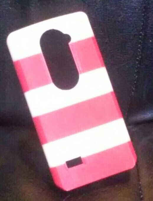

I finally got a good project to try this on. My wife wanted a Christmas themed cell phone case. thanks for sharing the technique.
Re: How to: "Not-Splice" Filament on its way into the M2
Whoa, that looks wicked! Great job!Slipshine wrote:I finally got a good project to try this on. My wife wanted a Christmas themed cell phone case. thanks for sharing the technique.

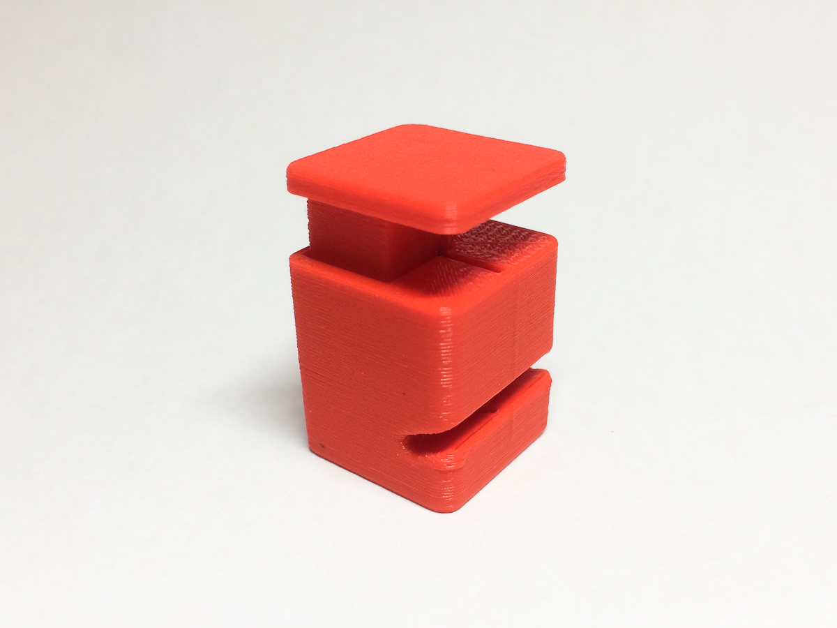

I've been meaning to make one of those little razor blade guillotines - just keep getting side-tracked before I sit down and search out a good file to try. (That would work better than the cutters, it would leave a flat edge on both ends, ready to go for next time.)jimc wrote:Never saw this thread until today. I have been doing this exact method for a couple years now and it works great. As long as the filament ends that but together are flat then the filament should just feed through smoothly. Never had a problem. I usually cut with a straight razor since that gives a flatter end but never had a problem using flush cutters either.
This One on thingiverse is pretty simple but it cuts on an angle... I've been meaning to redo it so it cuts straight for splicing but I just haven't gotten that far down on the to do list yet.
Ooooh....excellent find! Downloaded it to play with too! (I'd also like to add a notch, so that the filament doesn't have to be threaded through.)sthone wrote:This One on thingiverse is pretty simple but it cuts on an angle... I've been meaning to redo it so it cuts straight for splicing but I just haven't gotten that far down on the to do list yet.
Here you go Jules... Try This OneJules wrote:Ooooh....excellent find! Downloaded it to play with too! (I'd also like to add a notch, so that the filament doesn't have to be threaded through.)
Fan-freaking-tastic! I tried a redesign for a different blade, (which turned out to not be strong enough to cut through stiff PLA)....so I scrapped it, and hadn't gotten back to it. That saves some serious re-work!sthone wrote:Here you go Jules... Try This OneJules wrote:Ooooh....excellent find! Downloaded it to play with too! (I'd also like to add a notch, so that the filament doesn't have to be threaded through.)
(Just need to pick up some snap off blades next time I'm at Ace.) Awesomeness!
