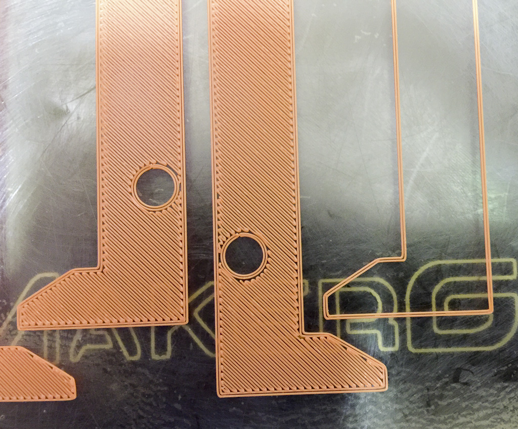

I just printed the cube
Nozzle Diameter: 0.35
Extrusion Multiplier: 0.83
Extrusion Width (manual): 0.44
First Layer Height: 100%
First Layer Width: 100%
First Layer Speed: 50%
When I print it the cube wall reads right at .44mm and the height is at 2.0 using a 0.15 offset.
Now when I try printing a print using these settings, except for Layer Width set to 115% this is what I get:
2015-09-19 18.16.39_1.jpg (451.96 KiB) Viewed 32893 times
This print is set for two outline layers and as you can see there is a gap between the two layers. I am also getting gaps at the circles, I've been getting these for a while even using different settings. So I'm wondering if this is a calibration problem of if there's something I may need to do to calibrate the stepper motors? Or do I just need to play around with the extrusion multiplier in order to get rid of the gap in the outer shells even though the cube is printing at the correct .44 wall thickness?
Even the solid area has the gaps so would the Infill extrusion width help with this?
Thanks for any feedback

Post by jimc » Sat Sep 19, 2015 11:36 pm
bed gap is too big.

Re: Extrusion calibration
Post by jdacal » Sat Sep 19, 2015 11:59 pm
jimc wrote:bed gap is too big.
Thanks Jim. So even though the cube walls are coming out to the correct measurements, my gap would still be off?

Post by jimc » Sun Sep 20, 2015 12:05 am
Yeah sure. Gotta remember its only affecting that first layer or first couple layers
