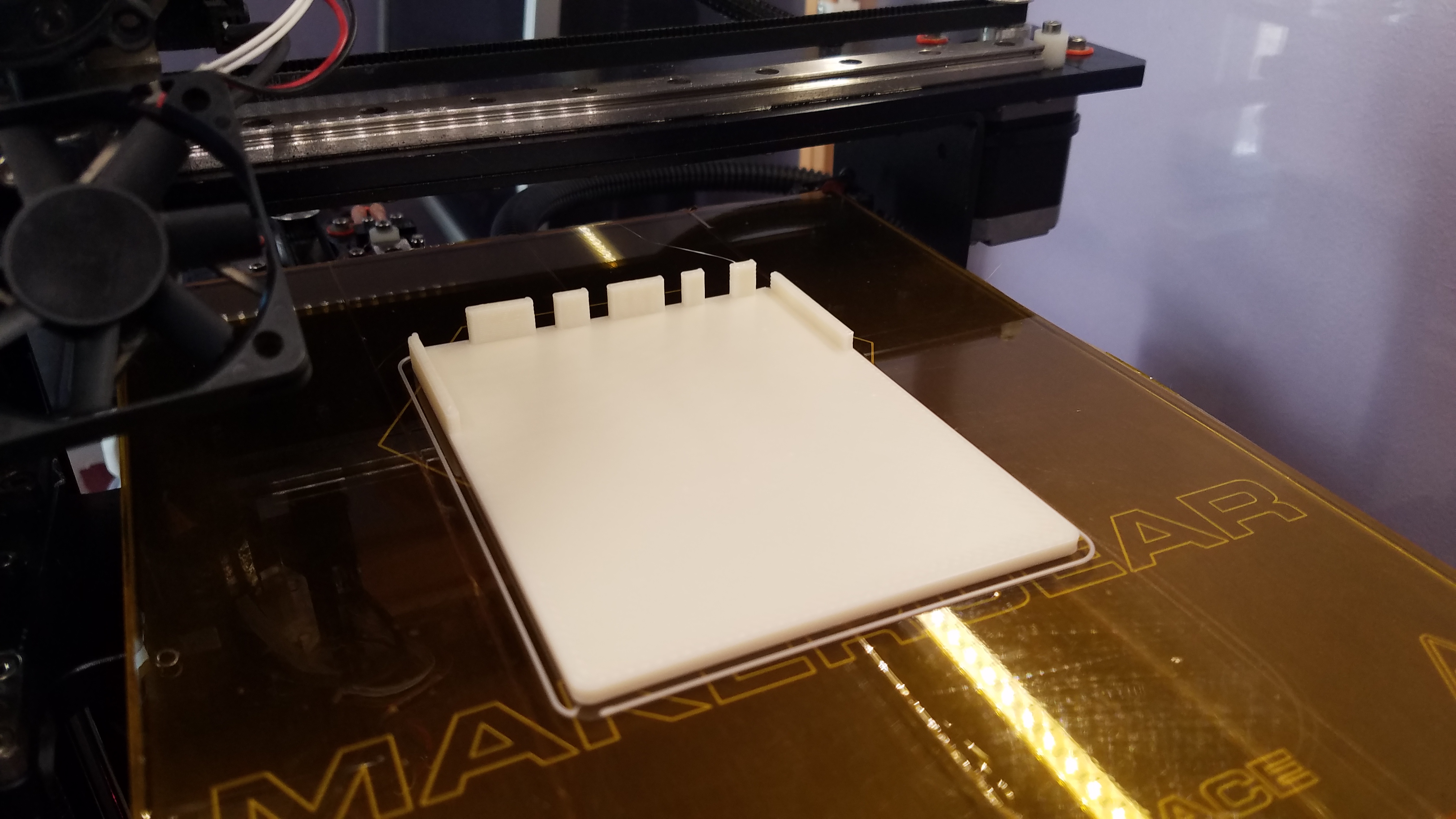

Printed this yesterday out of MakerGear Natural ABS.. their ABS is really good stuff not sure where they buy it but, like ALL ABS/Nylon/PETG has to be dried and stored in a vacuum bag to keep it dry. Sorry pic is not very clear.. but the point I wanted to show was no warping off the plate.
