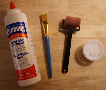

Lately I've tried mixing more solution than I need and storing it diluted. I use a brush to put it on the glass, wait a minute or two, then go over it with a roller to make it smooth and even. Here's my toolkit:
