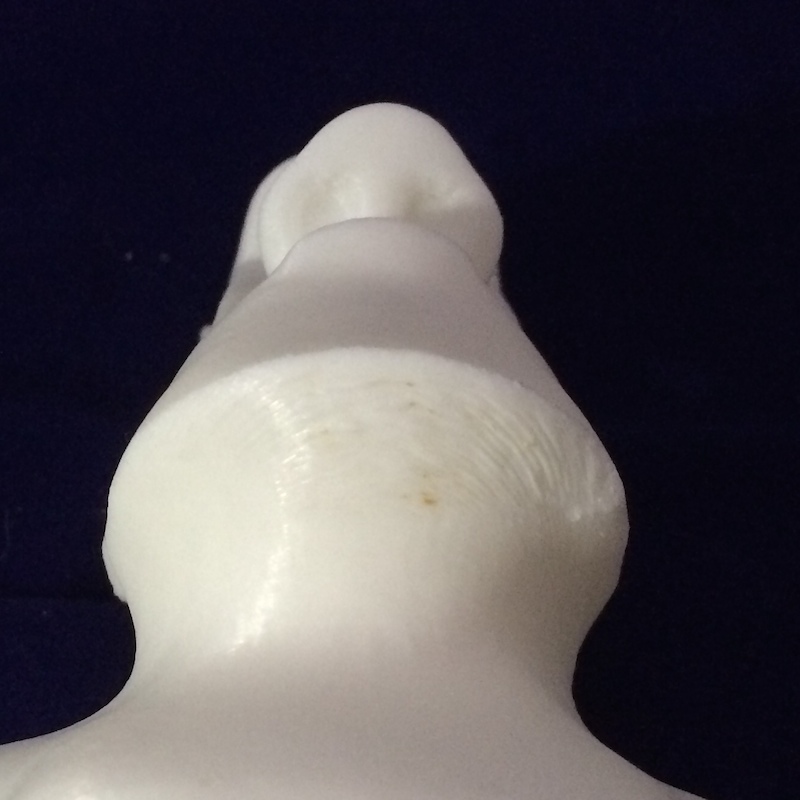

There are two issues at play: marring of the surface from little bits of support left over after detaching, and loose threads when printing overhangs that is what necessitates support in the first place.
On the first issue, I haven't really had those with Simplify3D. The support detaches cleanly and doesn't leave bits behind. It's the second issue which is most apparent. You can see it on the chin of the statue I have attached below.
The brown spots, I believe, are caused when the overhanging perimeter started to curl up during printing and wiped off some of the gunk on the outside of the nozzle.
I was about to say that there's no way to improve the loose threads, but I reread jim's comment. I thought he was talking about infill percentage at first, and thought that's interesting, why would that make any difference. But now I understand he's talking about support infill percentage, and yes, that should help.
Another option, if you can take it, is to reorient the print to not use supports at all by not having steep overhangs, even going so far as to segment the object into different parts and printing them in different orientations. It can be hard to join them afterwards with an invisible seam, though.
(Full photo of print here: http://www.thingiverse.com/make:75288 ; note the artfully hidden chin.)

Yes, it's the latter, the loose threads. In particular, there were many loose threads on the underside of this beetle print: http://www.thingiverse.com/thing:315586. I could try to reorient, but since the overhangs are quite low to the ground, more infill on the support shouldn't be too big a deal.jsc wrote:There are two issues at play: marring of the surface from little bits of support left over after detaching, and loose threads when printing overhangs that is what necessitates support in the first place.
