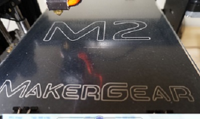

I'm starting to think this stuff may actually be an improvement over straight hair spray or elmers. I've printed about 8 times on one application and it shows no signs of wearing out. Here's the condition of it now:
It's almost like it was when first applied, with very minimal ghosting from past prints.
