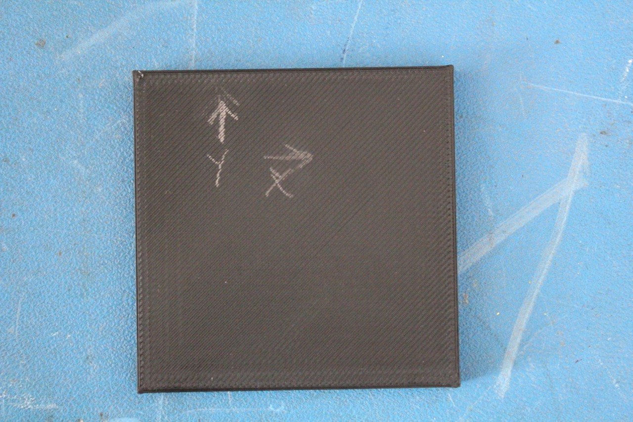

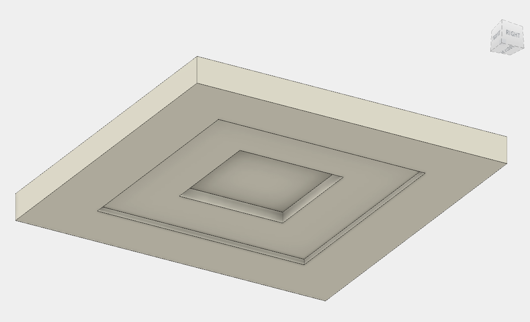

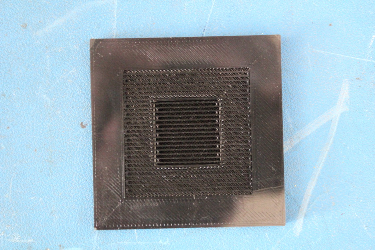

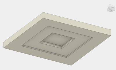

These photos aren't fantastic, but I hope they're good enough for you M2 experts to tell me if I'm on the right track with my extrusion calibration. I made this little 60mm square test piece to work with extrusion of flat horizontal surfaces over support. Extrusion multiplier is 0.9, temperature is 200C, and filament is the MG PLA that came with the printer. 0.35mm nozzle, 0.4mm extrusion width, 40% infill, 0.2mm layers, and 2mm support resolution. Solid layers are 3 on top, 3 on bottom, and 2 perimeters.
I think the top surface came out pretty well. It appears to be fully filled. Does this look right?
The bottom surface shows dense fill on the 10mm wide perimeter that printed on the scratched up PEI build surface. I left the support in place. The supported areas are stringy. My gut feeling is that this may be as good as I can expect under these parameters. What do y'all think?
Can I achieve better fill of large horizontal support surfaces using single extrusion? How about using dual extrusion with either dissolvable support or something like PETG over PLA (or vice versa), using solid support?

Top surface looks as good as any I've seen.
Your underside looks as good as you can get with those settings....it's not bad.

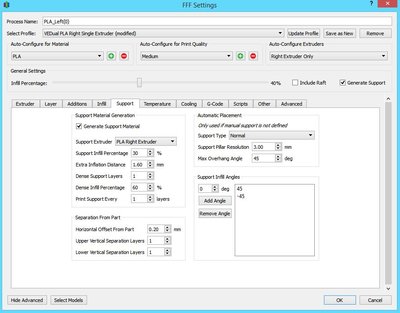

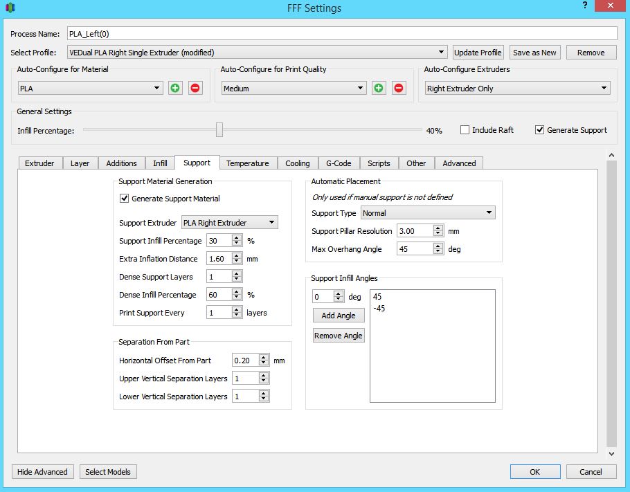

With a single...you can improve the underside of overhang areas somewhat, by using dense support layers (one or two) at about 60%. And i like to run the support in two directions in a cross hatched pattern. It's not quite as easy to remove, but it actually supports better.
My settings for PLA:
With a dual - you can get it almost as solid as the top surface, by using alternative filaments for the support and zero vertical separation. Never going to be perfect, but it's a lot better than printing over a one layer gap.
