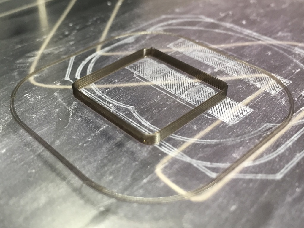

If printing the solid cube, change your settings to be single perimeter, no infill, no top or bottom layers. You will get a print like this:

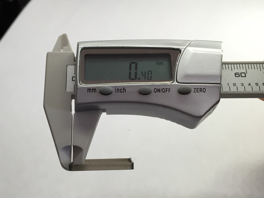

Caliper the wall at several points and eyeball the average thickness. I got measurements around 0.37mm with my current extrusion multiplier of 0.9 and extrusion width set manually to 0.40mm.
40/37 * 0.9 = .97, so I reset my extrusion multiplier to 0.97 and printed again. This time all the measurements center around 0.40 as they should:

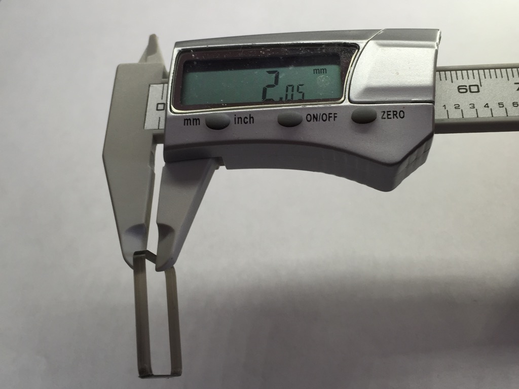

You can also take this opportunity to measure the height of the wall, which will tell you how much your z-height is off by (print using 100% first layer height):
. You can fiddle with the Z end stop to fix this, but easier is to just drop the number into the G-code offset field in Simplify3D: http://www.forum.makergear.com/viewtopic.php?f=8&t=2193
