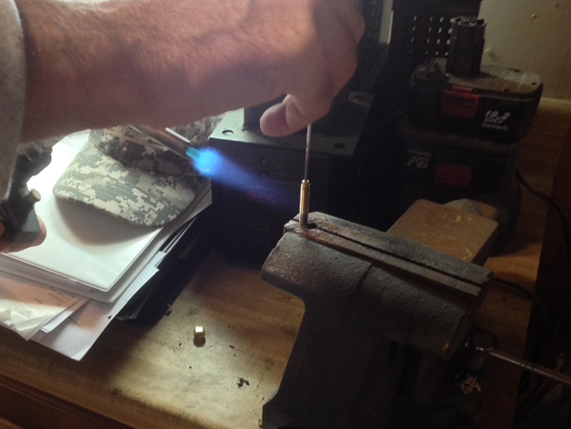

To clean the barrel you also need a benchtop vise, propane torch, needlenose pliers, and a piece of uncoated coat hanger wire. (To push out the melted clog.) The diameter is just about right to clear the barrel. We did try a perfectly sized wooden skewer as well. (Don't recommend using that though, because it does tend to catch fire. Bit of excitement there! :shock: )
Hubs agreed to demonstrate the cleanout process so I could take pics.......Here's a pic of him heating the barrel. Heat the tube by moving the torch flame closer, then pull it away to lower the heat. It doesn't take much. Just a couple of seconds. (And obviously you don't want to touch it.)

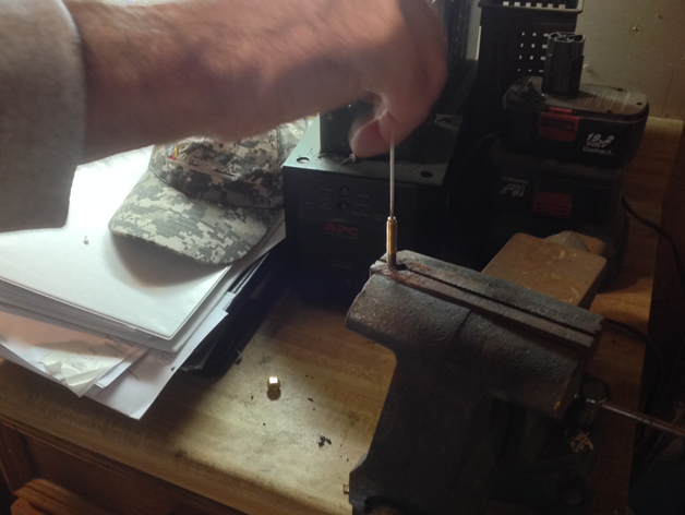

Use the coat hanger wire to stabilize the barrel in the vise and after heating, use it to push the clog out the bottom of the barrel.

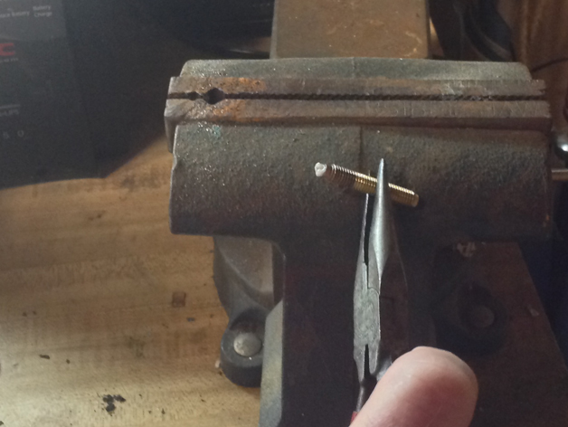

When you are done, use the needlenose pliers to remove the barrel from the vise and clear the clog off of the bottom of the barrel. (The white gob of goo in the photo.)

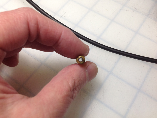

Finally, cool the barrel on an asbestos pad, or run it under some water and check it out - slick as a whistle!
