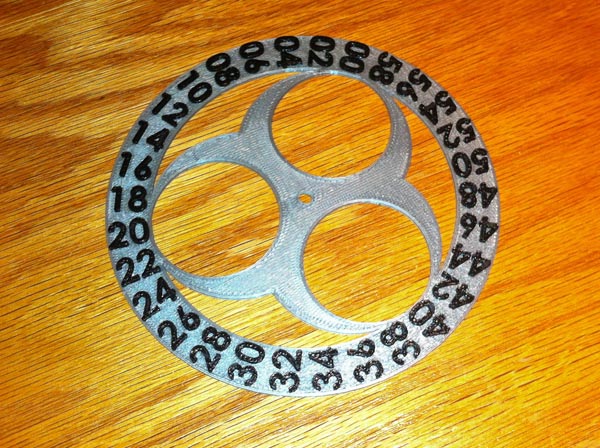

This is helpful if say you are running a print and would like to change filament color mid print. (Such as on the a part shown above.)

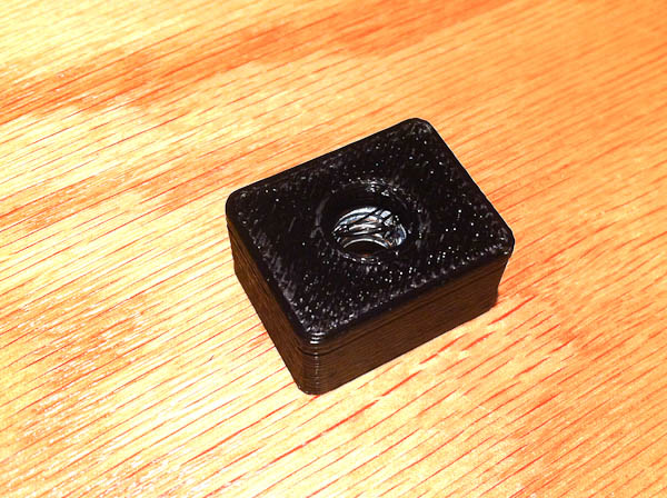

Another reason to use this method would be if you wanted to say imbed a nut into your print as seen above. (That's what I will be showing how to do in this tutorial.)

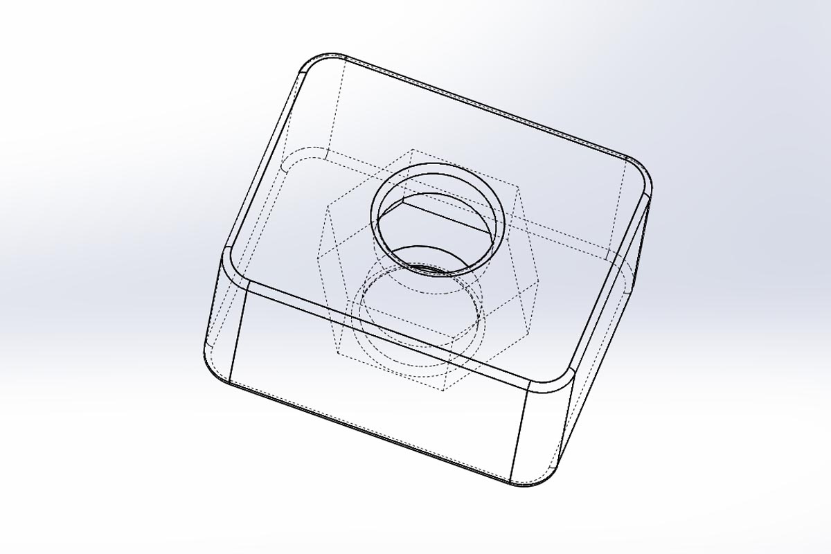

Tip - when designing your part leave adequate clearance so your nut will drop right into the print and also have room above it to clear the hot end once inserted.

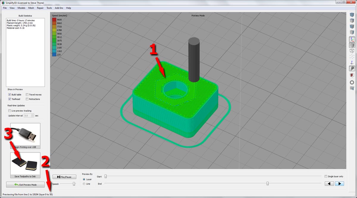

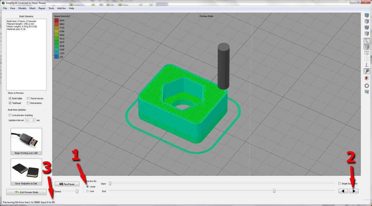

After importing the piece into your slicer (Simplify3D in this case) click Prepare to Print!
1. Make sure Preview By "Layer" in selected.
2. Click through the layers to find the layer you would like to stop the print at. (this is either where you want to insert the nut or change the filament color.)
3. The layer number is listed here.
1. For this tutorial I will be stopping before the layer that just starts to cover the nut.
2. Which is Layer 50 in this case.
3. After you have all your processes set and you know what layer you're stopping at save your G-code to disk.

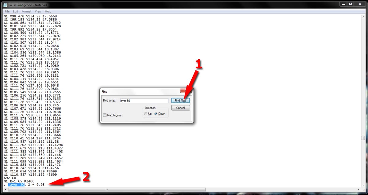

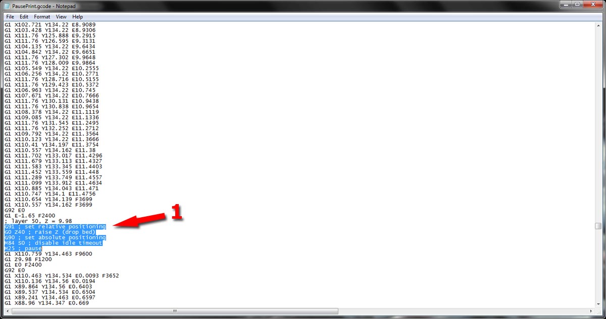

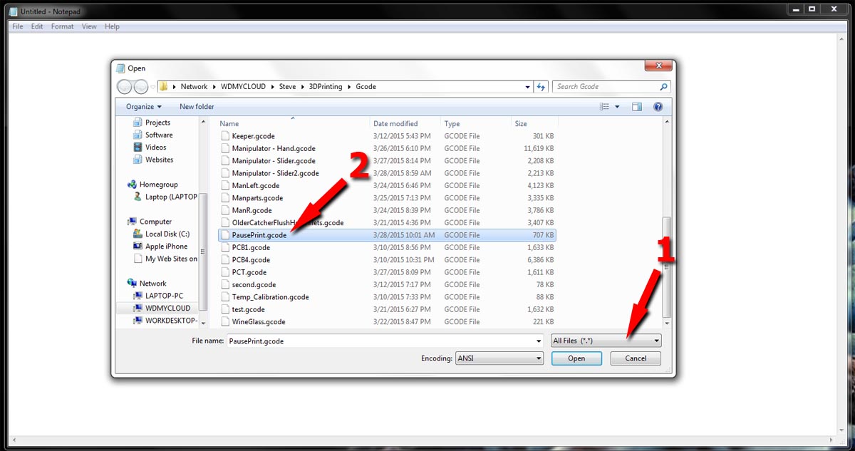

Next you will need to edit your G-code in a text editor. I just used Notepad. (Windows)
Click File Open. (Top Left corner)
1. Change this box to "All Files (*.*)".
2. Find your File, then click "Open"
1. Hit Control (Ctrl) F on your keyboard and then type in "layer (your number)" in the box that comes up (layer 50 in my case.)
2. It will highlight the right layer line for you in all that code. (you can hit "Cancel" now to close that box.)
Copy and paste the following code were it is shown above. (the G92 E0 in the code below was added since the screen shot above was taken.)

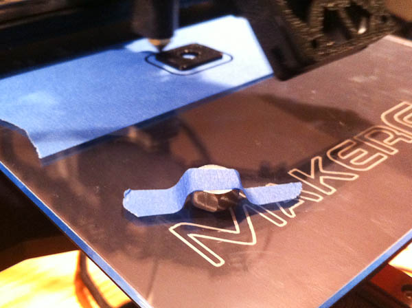

Tip - The first time I tried this I also added this code to layer 3 just to test to make sure it worked without having to print all 50 layers first.
As the part was printing I taped the nut to the Heated Bed to heat it up in the hopes the filament would stick to it better. If printing with ABS you could (in theory) coat the top of the nut with abs slurry or glue stick to help with adhesion.

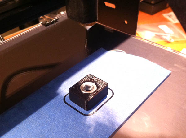

When the printer gets to the start of Layer 50 it should pause and drop the bed, at this point you can drop in the nut (making sure its low enough to clear the hot end when it resumes) or you can use the jog controls to retract and change your filament if you are just changing colors.

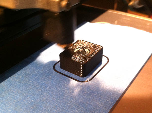

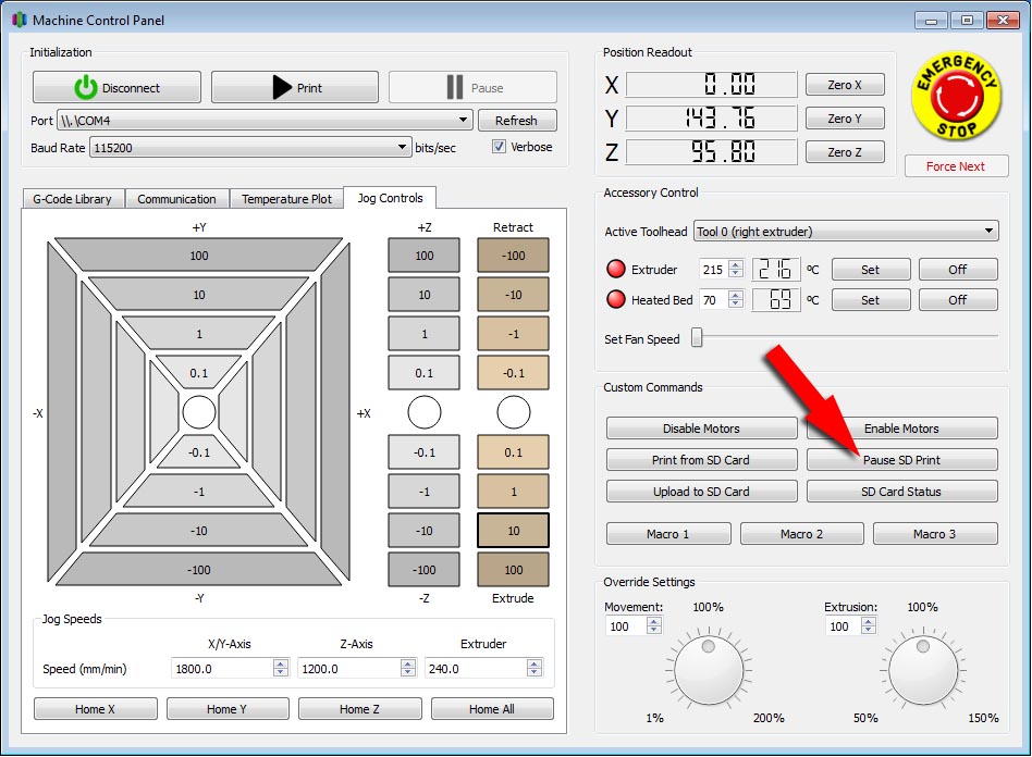

To restart the print you need to first click the "Pause SD Print" button (even thought its already stopped), the button will now say "Resume SD print" just click it again and the print should resume where it left off. (you may need to clip any ooze that happened during the pause from your hot end with tweezers while it's restarting)
(If running through Octoprint just hit the "Pause" button once to resume after the pause. Do not hit restart)
The filament didn't really stick to the nut to well so I did get some stringing over the hole and a blob on the hot end.
Here is the finished piece with the nut full embedded into the print. It looks like there's a layer adhesion problem where I stopped the print to insert the nut but I think that the filament that should have been the outer perimeter just got stuck to the nozzle for a bit after jumping over the nut.
