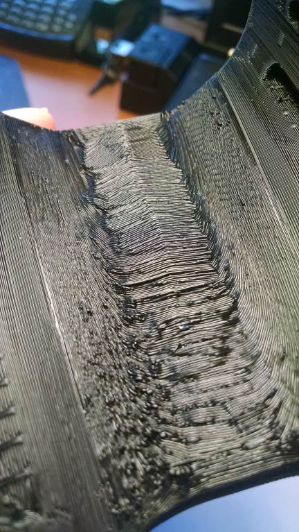

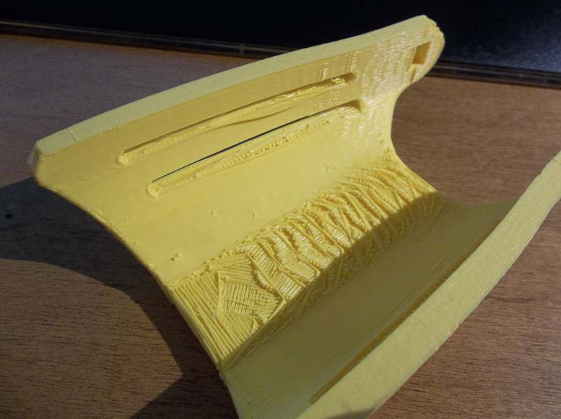

On several models that have horizontal or near horizontal overhang I am getting an odd pattern of single threads, even with support (See picture - center of Guantlet). I know this is the "big challenge" of FFF, I am looking for advice to make it better.
The model I am using to illustrate this is the "Gauntlet" from here: http://www.thingiverse.com/thing:596966, from the e-nable initiative.

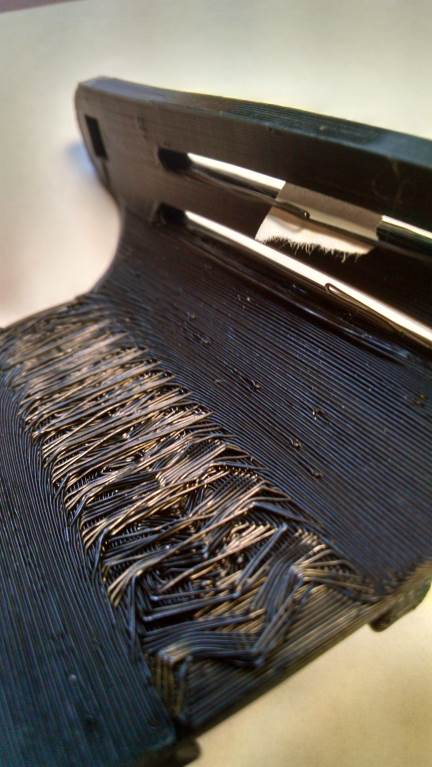

There are also some long slots that are a challenge and tend to have "fallen strings", even with Simplify supports (Under paper in picture) - in fact the supports did not seem to have much impact but I may try some different supports (the photo is without supports in the slots, modeled supports for the center).
odd pattern
I have tried it with the supports in the model as well as supports from Simplify3d. Simplify looked a bit better but not great. It seems like there is something odd going on with the way it is sliced that may be causing this problem. I have tried slowing bridging WAY down (20% and 80% fill) as well as the various support. Other than these fully horizontal sections, I have been surprised how well it did on the "almost vertical" parts which suggests overhangs as much as 65 Degrees can be done without support.
The other parts of the model look fine and the calibration has been done for the filament. (Well, almost fine - there are some small "divots" I am trying to get rid of as well).
Thoughts?

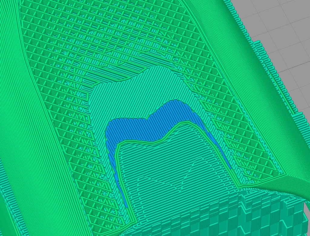

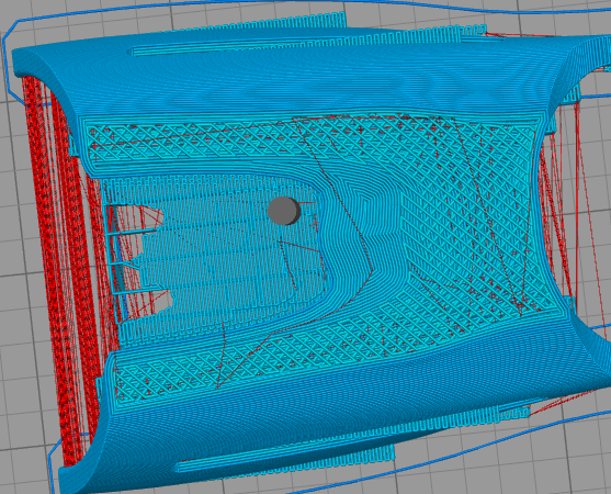

If you look at the gcode preview for that file, you will see that the layers want to curve in and start doing a little wiggle over the support on each layer. Having any sort of curves over support is tricky, because in order to be able to remove it the slicer needs to put in a gap between support and model, and curves will tend to cut the corner. You may have seen this when you're not getting good first layer adhesion and trying to print holes or convex curves.
Suggestions: check your support settings to see what upper vertical separation layers is set to. If it's not 1, make it 1.
Slow the layers that contain the overhang way down. You said you slowed bridging down, but it's not a bridge, so if you just set the bridging settings, that won't take effect here. Use separate processes to slow just those layers down.
Print the whole thing upside down, which would take less total support anyway.

jsc wrote:If you look at the gcode preview for that file, you will see that the layers want to curve in and start doing a little wiggle over the support on each layer.
Wiggles over a support would seem a bad idea, is there any way to stop that? I think that is the pattern seen, even when printed over the "built in" supports. Any place you have partially or fully unsupported regions I would think you would want a straight line of minimum length - in this case it changes direction in the worse place. Also, it doesn't even seem to be putting in sufficient plastic to fill the void.

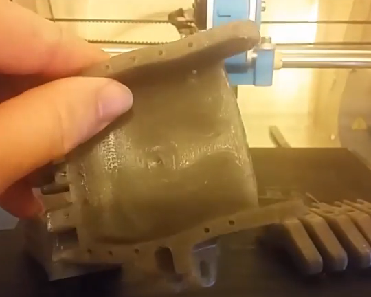

This video shows a similar part from the same source: https://www.youtube.com/watch?v=OLJJ0T801Qc
Here is a screen shot from that video (last minute or so):
Part printed in video
Differences I noted: The built-in support was much more tightly attached than mine, which mostly dropped out like it was not attached. His resulting print was very smooth, note that he used Cura slicer. He used the model with built-in supports, so support options would not matter. Also, the model looks smoother - even with the same layer height - makes me wonder if layer width (.42) or extrusion isn't ideal. You can see every strand in my print, on all surfaces.

The wiggles are because that's what the model geometry requires. It's not a straight bridge, there are two subtle grooves being printed at an angle.

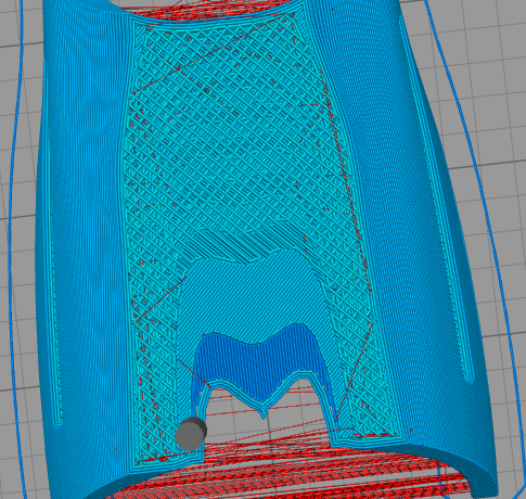

I think I see what is going on. The mostly horizontal surface is at an angle and, perhaps, a slight bow - so the layers would be "terraced" in some way. S3D's response to this is to print this "wiggle" pattern but for some reason is not doing it well - you will note that there is space between the filament lines on the same layer - the layers are not fully filled. On a test I flattened the horizontal bottom and it then made a square pattern. that was filled.
So problem one is that S3D is not slicing this well and is producing a sparse layer. Then compound this with the "wiggle" over a support and it pulls the filament out of wiggle room. Perhaps if it was very slow this may work, but I think problem 1 would still be there. Does this sound reasonable?

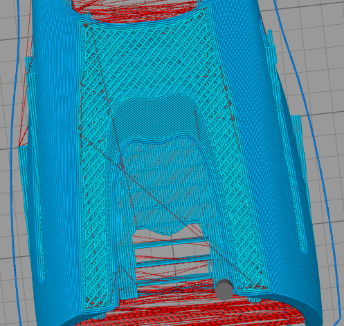

Oh, hey, I just sliced the one with the included support. You definitely don't want to use that. I was wondering why you guys kept referring to "bridging" when it shouldn't be bridging at all. Well, with the included support model, it doesn't know that it's support and is in fact trying to bridge on the bottom layers. Plus, the "support" is actually a mostly hollow box with beams (scrub the End slider at the bottom to see what the interior looks like) and it will be trying to actually run curves over thin air between the beams; with only three top layers the quality of the top of the support structure will be abysmal. Use S3D supports with 3 dense 80% layers and one top layer separation, and it should do a much better job. Although, it kind of sounds like you already tried that?

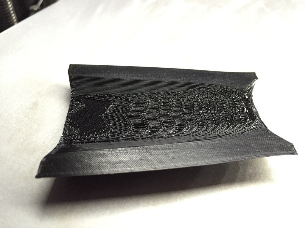

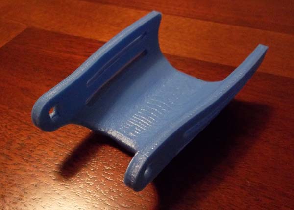

Here's my test of just the area in question.

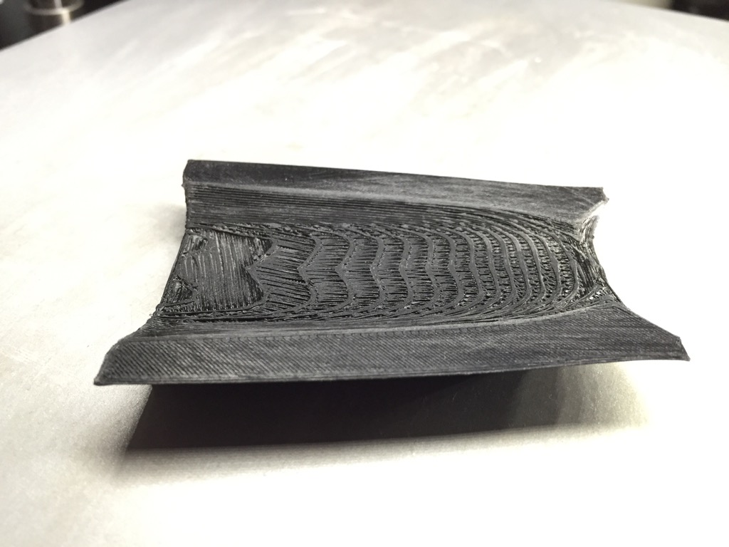

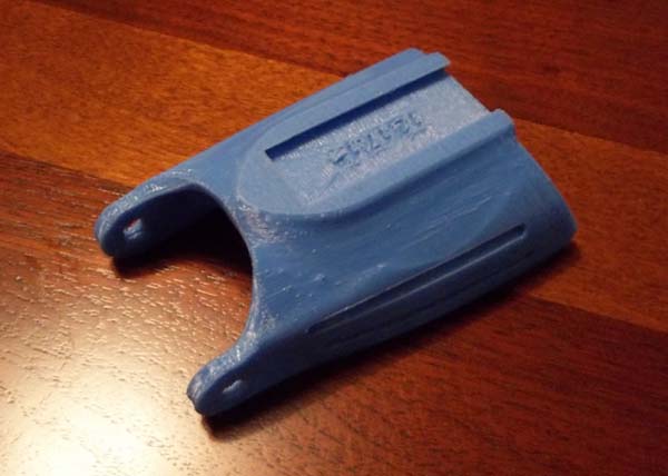

And after some half-assed sanding:
Also, that screenshot doesn't show the same part. It's not the gauntlet, it's "left palm supported".
If I were printing the whole thing, I would flip the whole thing upside down, set supports to 60 degree overhang and 2mm grid, and let it rip. Print time reduced by about half.
