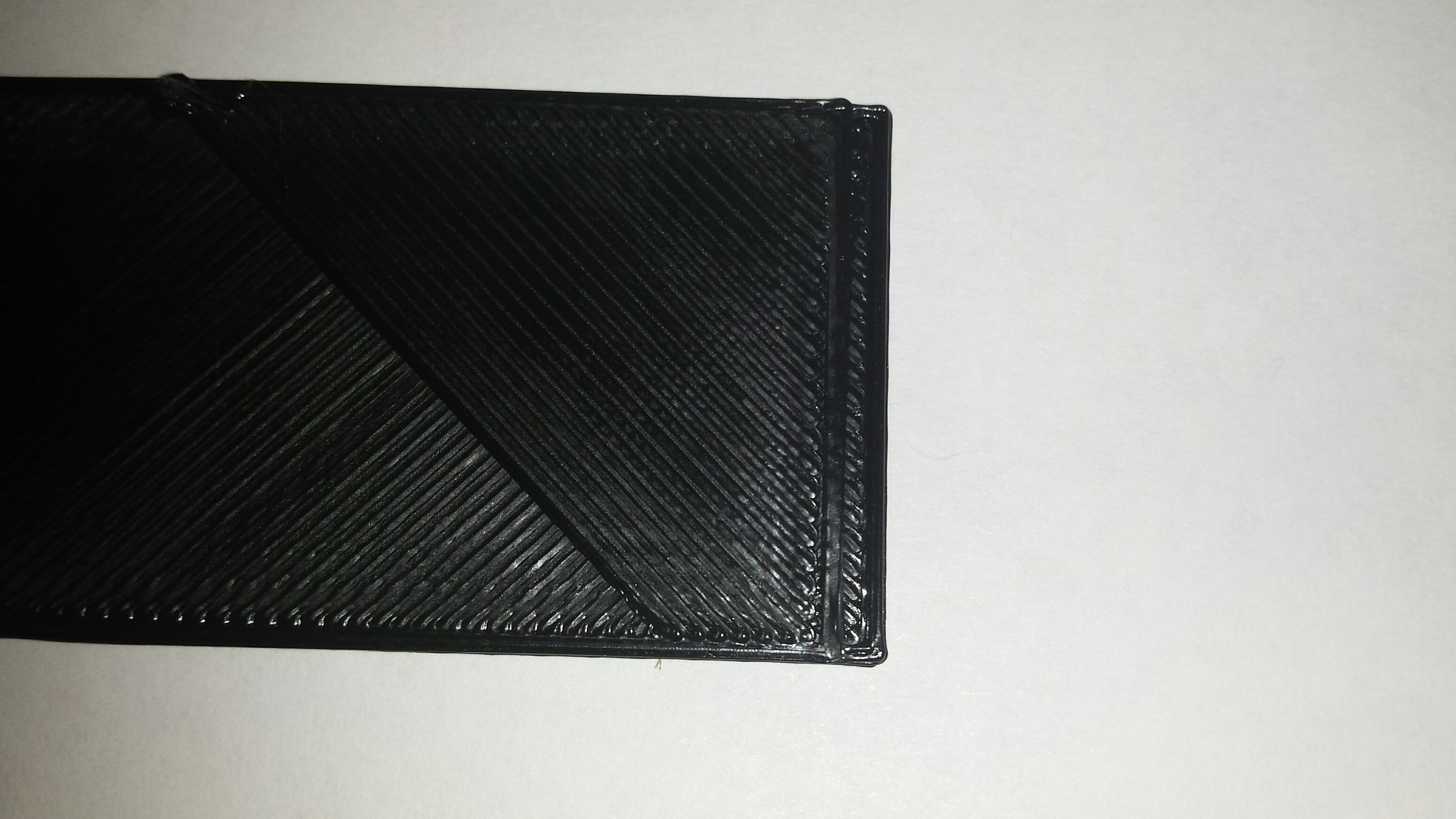

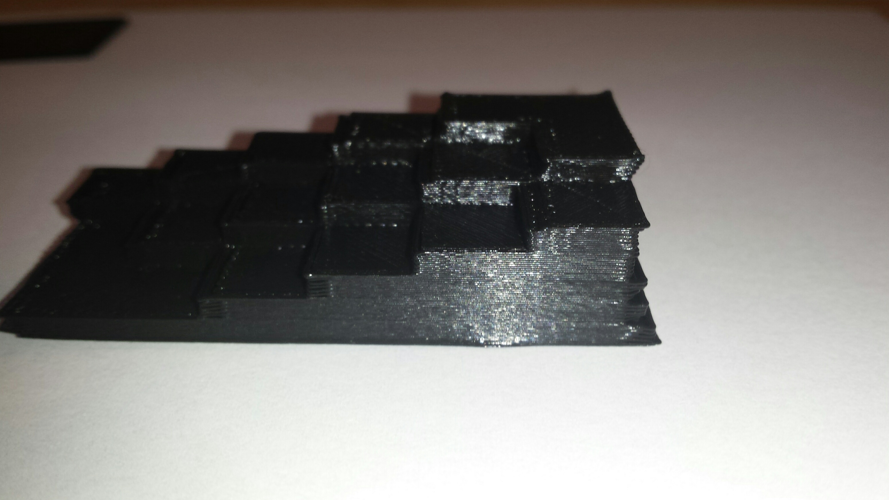

Hi, be having some difficulties getting my prints out nicely. It seems every couple of layers the next layer shifts a mm on the y axis. I know there are a few posts on layer shifting but it seems in my case its almost random, where a flat wall would be, well flat, its waves back and forth. Take a look and let me know what you guys think. :D
Re: Layer shifting
Post by insta » Tue Aug 25, 2015 3:00 am
Enable Z-hop (vertical lift retraction) in your slicer, by setting it to 0.2mm, and try again.

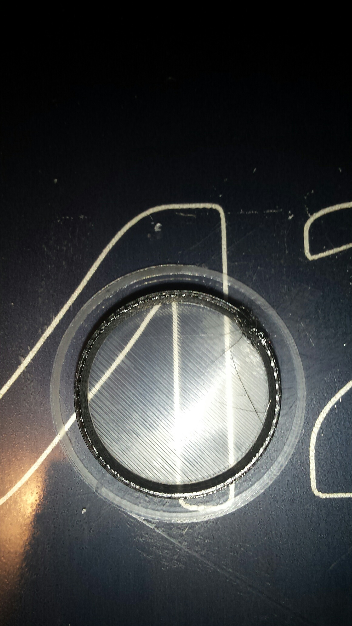

That might be a loose set-screw on the Y axis pulley. Can you print a single-walled cylinder in vase mode, and take an overhead picture?
Kyle-312
Posts: 7
Joined: Fri Aug 21, 2015 5:18 am
Re: Layer shifting
Post by Kyle-312 » Tue Aug 25, 2015 4:17 am
[attachment=0]20150824_211234_resized.jpg[/attachment IMG=20x20]
okay, printed seems to be fairly even minus a but if over extrusion

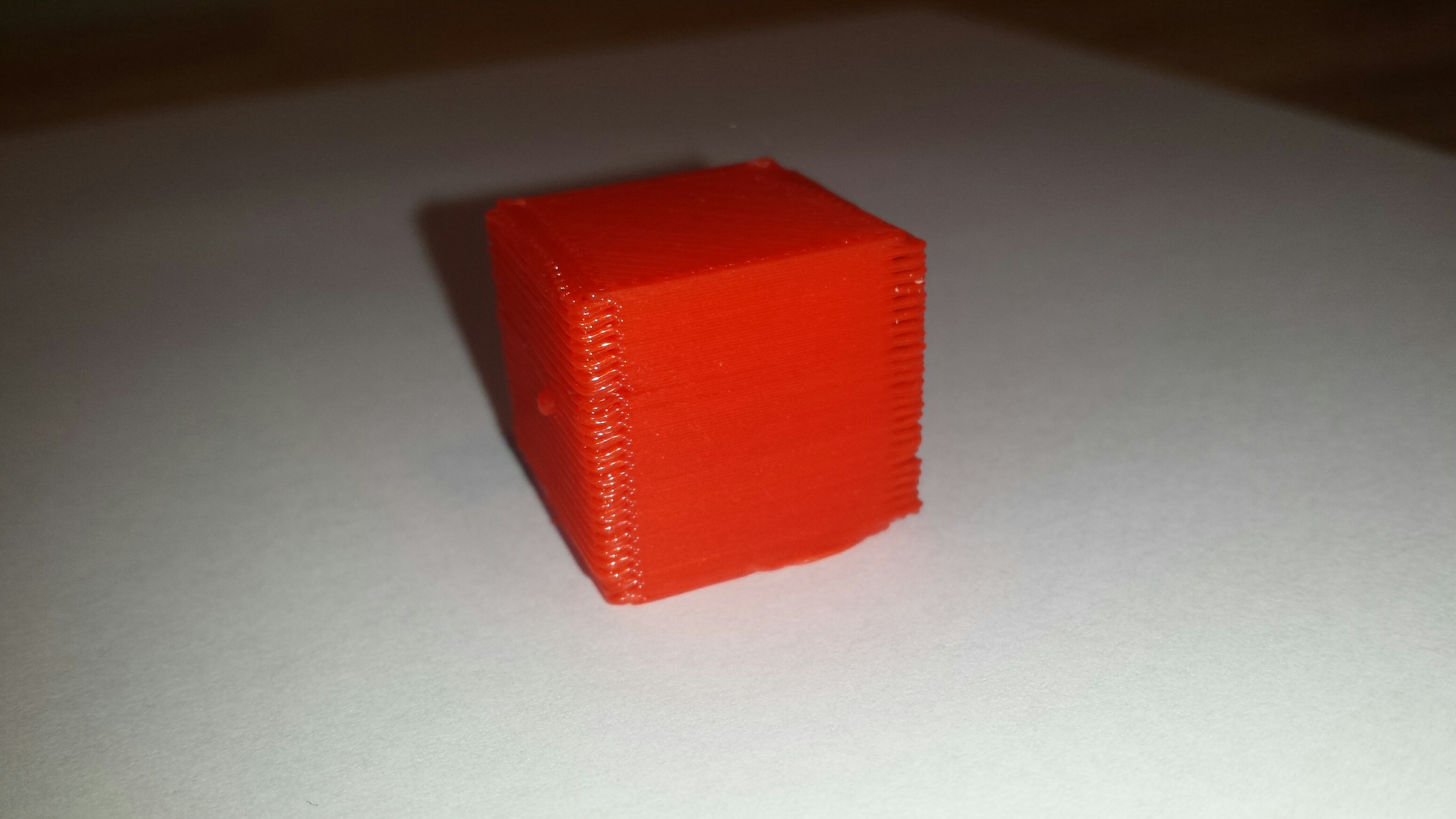

Post by Kyle-312 » Tue Aug 25, 2015 6:03 pm
0.2mm retraction.jpg (5.65 KiB) Viewed 11713 times
i did lower the printing speed and tighten all screws a bit more to help it out
