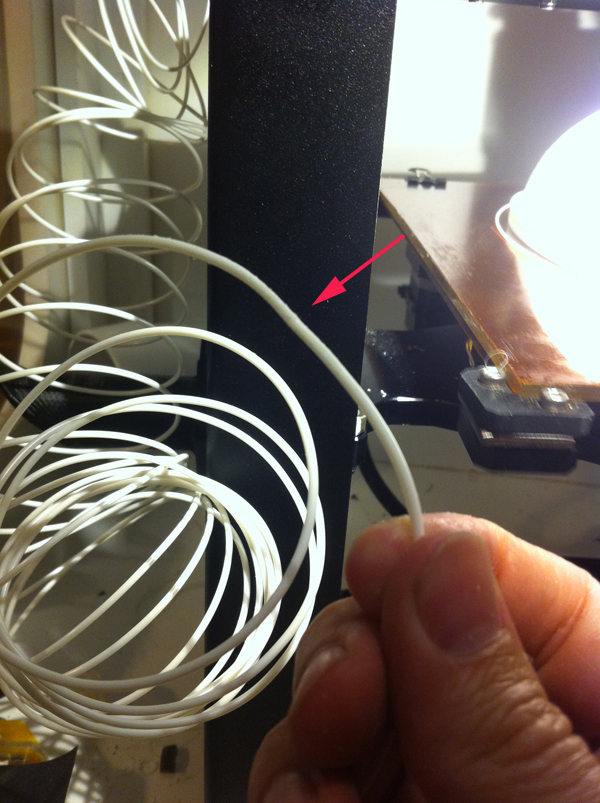

I'm printing ABS. I've got the splice done and put the new roll on. The easiest way I found was to hold one end in each hand and touch them both to a hot soldering iron at the same time, then smoosh them together real fast and hold until solid. The hard part is getting them exactly end to end, especially with vision as bad as mine is up close. The excess that mushrooms out was clipped and then sanded flat. It looks pretty good in the image below, as long as it doesn't break. Not sure if it will ever make it to the extruder, now it is looking like the print might finish without reaching the splice. Better safe than sorry though. I wish I marked a line where the splice was so I could know when it is about to go through. It is pretty much invisible now.
