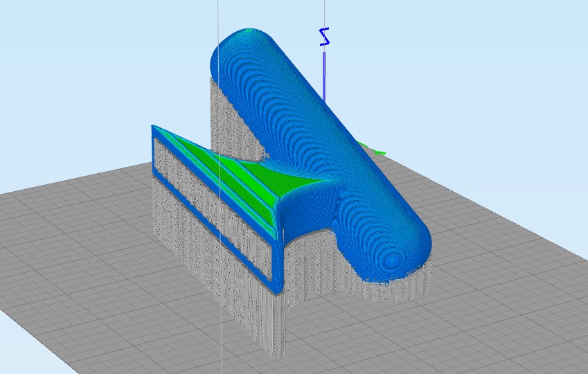

Does anyone know the basic rule on getting Great results on support settings? I am printing PETG and some of the support structure looks like it's going to do a great job in the Preview Window, but in reality is looks like Poop !
Preview of Structure

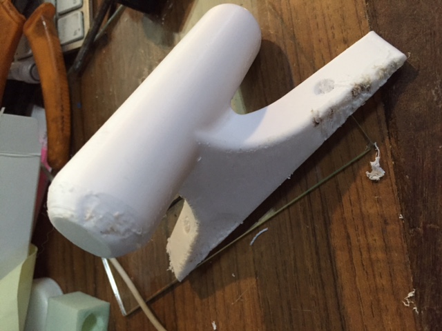

Here is the Results....
Results

It's a bit hard to tell what's going on inside that, ah, lump, but can you split the model down the middle, print the two halves with the split face downward, then glue them together? That might eliminate all the support structures and, as nearly as I can tell, the best support is none at all.

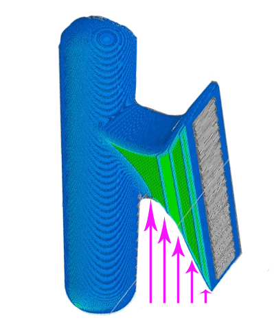

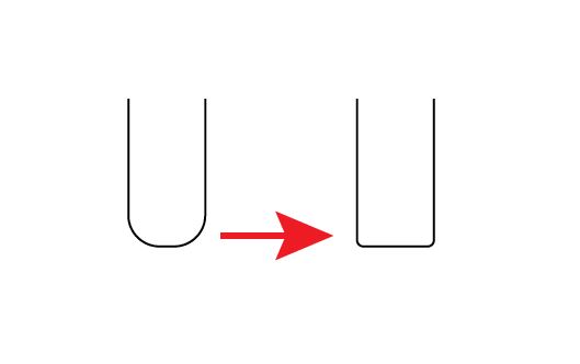

If i absolutely had to print something that looked like that in PETG, and I knew it couldn't be cut and reglued, I would flatten one (or both) rounded end a bit and try to print it in this direction, with support and a brim:
(Or the other direction, depending on which distance is shorter.) That will give you a rounded, unblemished cylinder part. There will still be some cleanup on the handle, but when the curve is going in that direction (convex? concave?) with support underneath it, it tends to require a lot less cleanup.

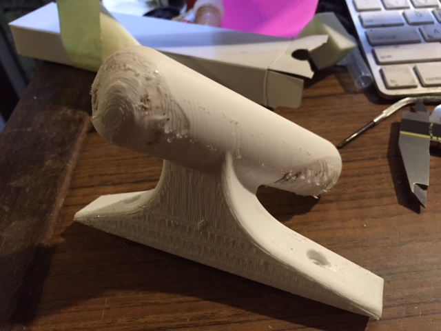

Post by TheRyanRanch » Sun Oct 04, 2015 1:48 am
Jules wrote:Agree with all of the above! :D
The attachment Untitled-1.jpg is no longer available
Hi Jules, I did try that orientation and I was almost successful, again where the handle had support under it, this would become a rough surface. I have printed this same part on my Afinia Printer (in ABS) and the Algorithm for their support in their software left almost a perfect surface after breaking the support off the part. I think if I can emulate what the Afinia Software is doing, I might get even closer to my end result.
more results.jpg (91.53 KiB) Viewed 24429 times

Post by Jules » Sun Oct 04, 2015 2:26 am
One other thing you could do to make it print just about right is to flatten out the roundness of the cylinders at the ends.
Support is hardest for that rounded shape on the bottom of a print:
