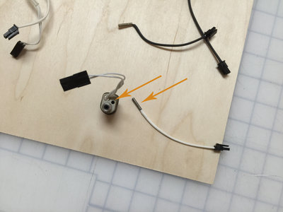

3. Disconnect the hot-end extruder wires and thermistor wire at the connectors near the motors.

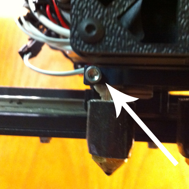

4. Swing the fan up out of the way. Loosen the screw that holds the hot-end in place on the hot end mount under the fan assembly. Allow the cooled hot-end to drop down into your hand.

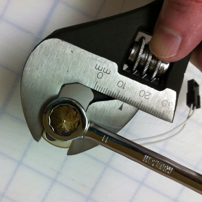

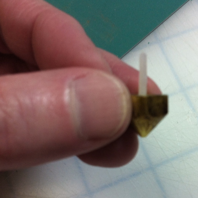

6. Use two wrenches (adjustable and flat, or two adjustable wrenches) to just loosen the nozzle from the hot block. Grab the block near the nozzle, not near the neck. Do not twist the nozzle completely off, just loosen it so you can turn it by hand.

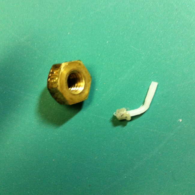

7. Gently twist the nozzle off by hand, back and forth to break the filament seal in the barrel, and pulling out away from the barrel to stretch the filament inside. Ideally, you want to loosen the filament in the barrel and pull it out in a long tube. It cleans the barrel (not necessary, but nice) and gives you a handle to work with for the nozzle cleaning.

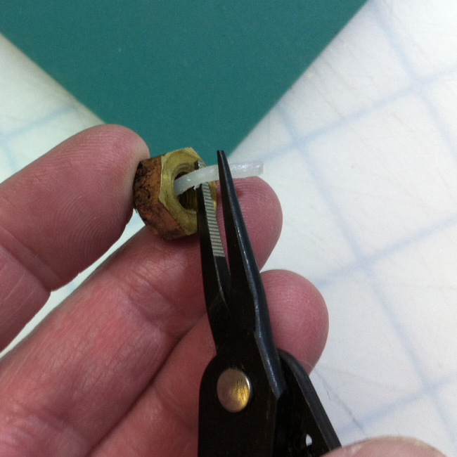

8. Firmly grasp the tail of the filament with a pair of needle nose pliers and gently roll it towards the side to pull the plug up out of the nozzle. Rock it a bit back and forth on all four sides to break the seal if you can. (Feel free to use your thumbs in the process, mine is holding the pliers in place so i can hold the camera in the other hand! ROFL!)
9. When the filament plug lets go, it will pull out little bits of carbon that have been baked onto the nozzle. (Black specs in the plug.)
10. Once you have removed the plug, hold the nozzle up to a light and see if you can see clear through the hole. If you can, great, put the nozzle back on, the clog is cleared.
11. If you break the plastic off in the nozzle, (no handle to grab), you can still use one of the other methods to clear the clog. (Propane torch, or solvents to dissolve the plastic over several hours.)

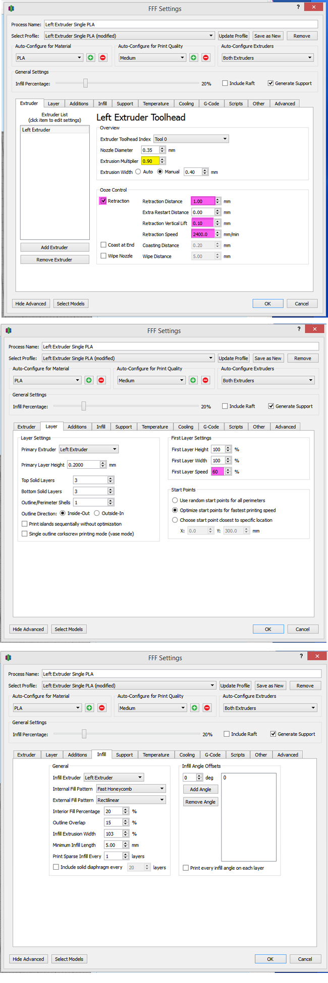

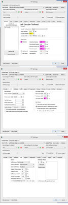

Re: How To: Take Apart the V4 Hot End for Cold Cleaning
Are you using S3D?

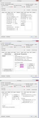

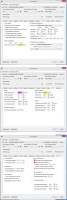

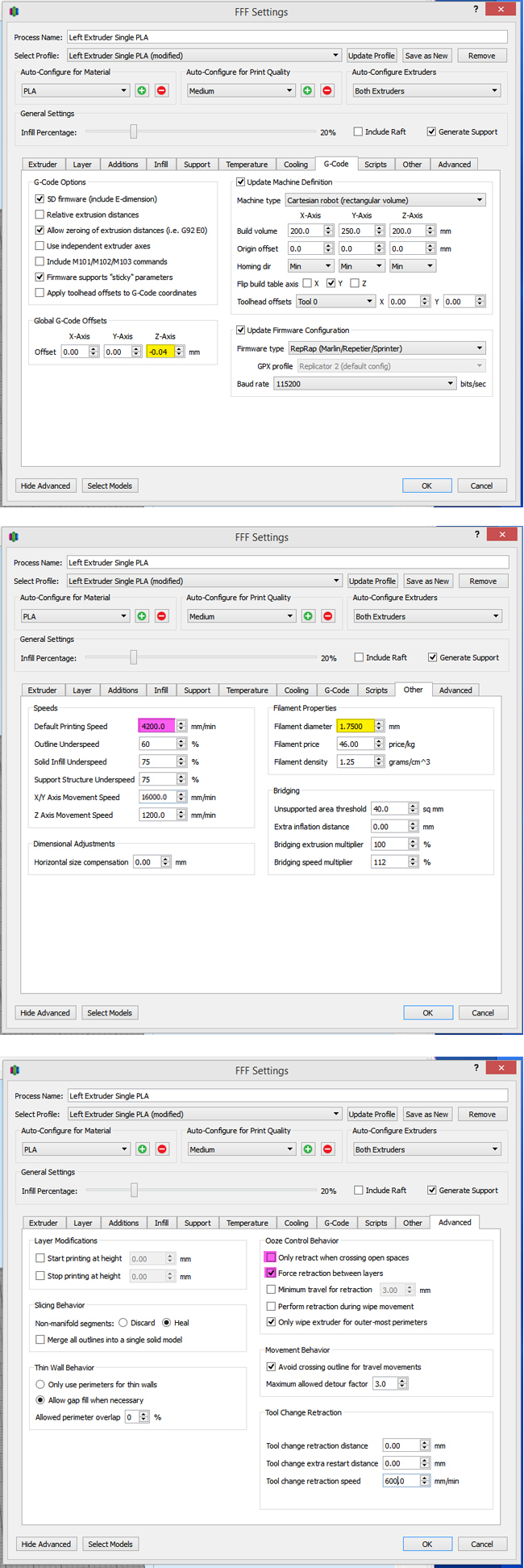

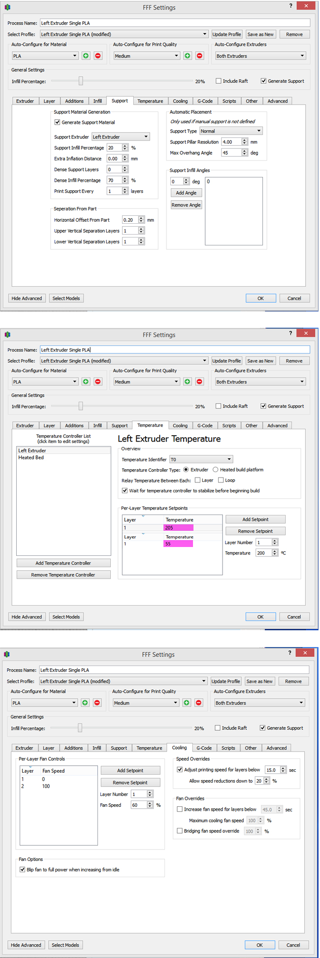

Try these settings for PLA:
(As opposed to typing all of this stuff up, i did screen caps.)
You need to change the settings highlighted in yellow to match the settings that you determined were correct based on your calibrations.
(Make note of the ones in pink and make sure they match.)
(Looks like the thumbnails are working insta!)

Thanks, going to give these a try.
