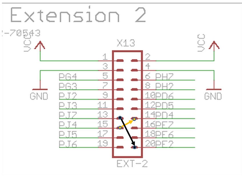

After the wiring change the VIKI blinks between the home screen and some other screen and doesn't work. Did I misunderstand the wiring change or is something else wrong?
The wiring instructions listed were a little difficult to decipher but if I understand it correctly you do the following as shown in the attached figure:
1. Move the yellow wire from EXT2 pin 15 to EXT2 pin 14.
2. Move the Black wire from EXT2 pin 13 to EXT2 pin 20.
Attached is other supporting information I used in case anyone else is trying to do this... As shown, the EXT2 Pin 1 is at the bottom left of the header.
VIKI PIN CHANGE FOR CURTIS' FIRMWARE.JPG (53.09 KiB) Viewed 27899 times

Not having a Viki, that looks right to me. Maybe a photo of your current wiring setup to confirm?

Hey Tony,
There are two yellow wires from the VIKI that end up on the EXT2 pins. Make sure the yellow and black wires that you are moving are the ones that are from the same harness on the VIKI. That should leave a white and yellow wire (from the other VIKI harness) connected to EXT2 pins 19 and 17 respectively.

I tried moving each of the yellow wires just in case I had them backwards when I installed it the first time. That didn't work.
I will double check ALL of the wires using the list on the MakerGear Wiki when I get home tonight. If I don't find the problem I'll post a picture of what I have.

I went through all the wiring and made sure everything was correct. When I turned it on it worked. I turned it on today and its back to switching between the main screen and the screen that comes up when you push the center button. Any ideas? Think its a wire that's losing continuity? I suspect one of the wires that was moved since one of those is related to connecting one of the VIKI buttons that was previously unused, if I remember correctly.

Pull the black wire from EXT2 pin 20 and see if it quits. That's the wire that makes the little button next to the sdcard on the VIKI work. It's rather useless, so if that fixes it no big loss...

When I unplugged the entire bottom connector of the VIKI the flashing stopped and everything is still controllable. I guess that means the bottom connector is related to the SD card?
I'll try plugging the bottom connector back in then unplugging EXT2 20 and see what happens.
