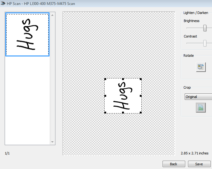

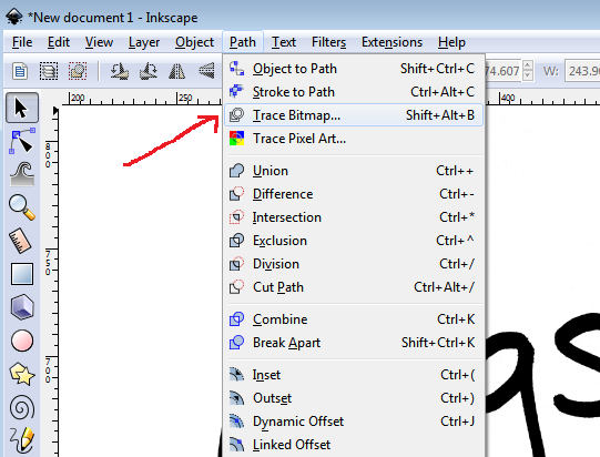

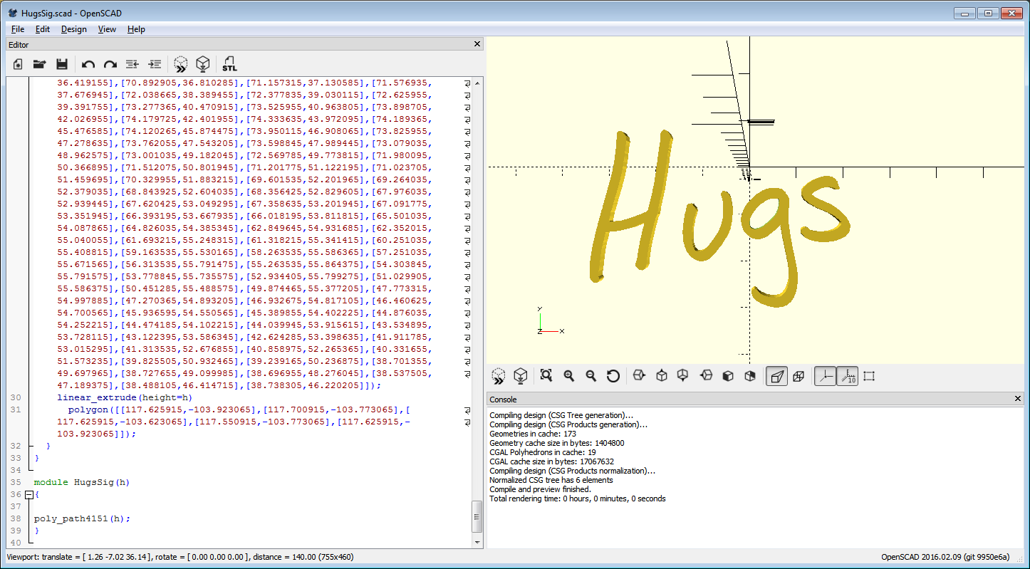

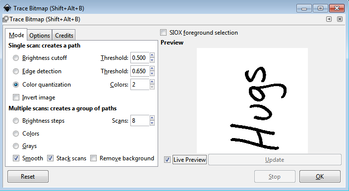

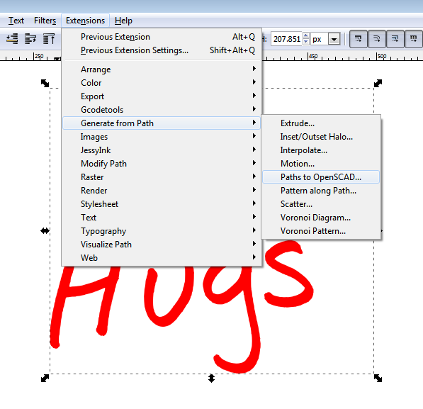

Here's a quick demo I just did using the Paths to OpenSCAD plugin for Inkscape, and OpenSCAD:
Scan my signature:
Open and trace it in Inkscape:
Tweak settings to your liking
Export using the "Paths to OpenSCAD" extension:
Tweak in OpenSCAD:
From this point, I could load the STL of the model I want to sign and use OpenSCAD "union()" to merge the "signature" with it. It would take a bit of fiddling with scaling/rotating/translating but I've used this process on a bunch of prints to add logos and such.
