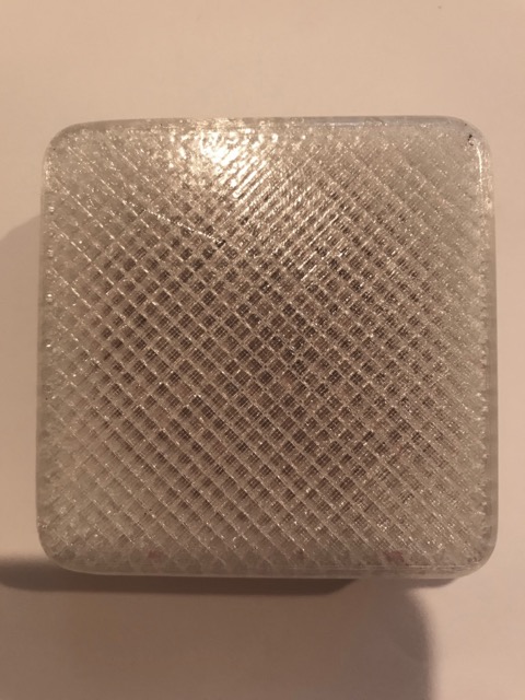

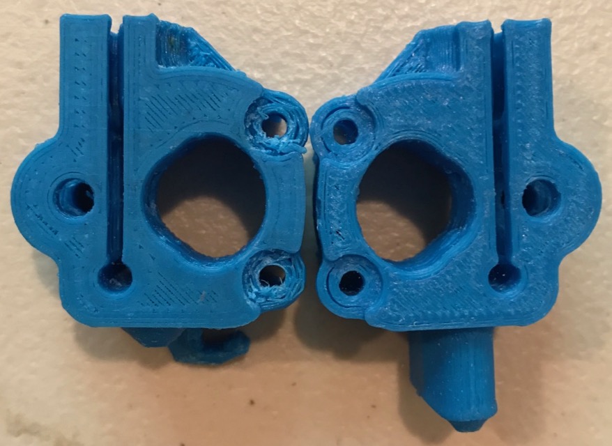

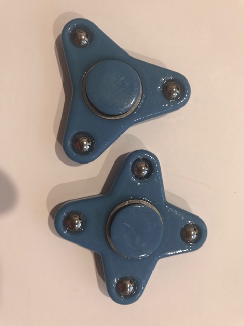

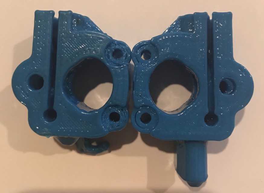

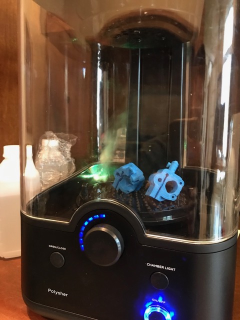

I have printed several objects now using the .35 and .5 nozzle at .2 layer height. I found that with higher layer heights the filament blobs together and looks sloppy. I have not calibrated it. I simply copied the PLA settings in Simplify 3D. Dropping the support resolution down to 2mm fixed the problem of the supports not popping off. The transparent filament must have to printed in vase mode or thin walls, if not, all you see clearly is the the infill. The polishing itself is easy. Included pictures are the filament drives for the M2 before and after. If the print isn't "smashed down" at the beginning then the first layer is uneven as seen on the filament drive. After polishing it is less noticeable but still evident. All the prints are shiny after polishing.
Re: Polymaker Polysmooth Profile for Simplify3D
FYI, if the filament has PLA-like properties then it is not appropriate for a filament drive. Fine to print, just don't try using it. . .
